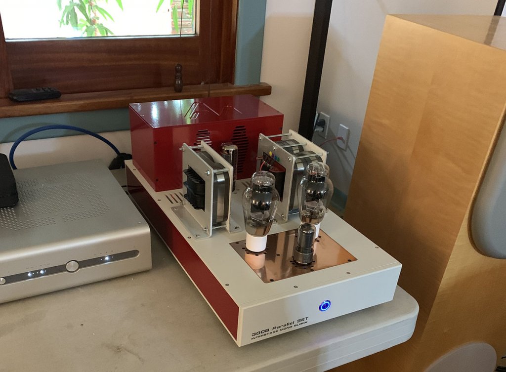

I built a pair of monoblocks based on the ANK 300b C-Core Interstage Monoblock kit, but I made a number of modifications and built my own enclosure. I have a build thread on the Steve Hoffman forum. https://forums.stevehoffman.tv/threads/ank-300b-interstage-monoblocks.1112018/
I'm very pleased with the way they sound. I'm using Western Electric new issue tubes. I've probably averaged 7-8 hours/day for the past 16 months and they've been rock solid. They replaced a pair of Pass XA60.8 monoblocks. Vocals sound absolutely gorgeous. They are completely silent - no audible hiss or hum from my 98db/w speakers. Soundstage is wide and deep.
I should note that I am using powered woofers which cover up to about 170Hz, so I can't really comment on the low bass performance.

Very beautiful set up!🙂

sweet setup jaytor!
what speakers are those?

Thanks guys. The tall light-gray columns are DIY GR-Research Line Forces. These are two-way line arrays using six Bohlender-Graebener NEO10 drivers, and sixteen NEO3 (from GR-Research) drivers. I built the crossover using the best parts I could source and still fit in the available space.
The woofer towers are DIY GR-Research Triple-Threat servo controlled woofers (three 12" woofers). The combination is right up there with the best speakers I've heard.  There are a few six-figure speakers I've heard that I think sound a touch better, but not by much.
