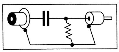

When I think of a single homemade sub with a 15" driver, I think slooow. You will never get the NX Studio's to integrate seamlessly.
The idea of using the NX Studio with a 15" sub reminds me of Corey Greenberg's review of the NHT SuperZero loudspeaker & SW2 subwoofer.
NHT SuperZero loudspeaker & SW2 subwoofer review
https://www.stereophile.com/standloudspeakers/804/index.html
I heard the Super Zero/SW2 sub combo at a local stereo store. The salesman was thrilled with the setup but to me it sounded like two different speakers trying to play the same song, the music couldn't figure out where it wanted to come from depending on the frequency.
How high up does the sub play? 130 Hz? If you want to give it a try then the review has directions how to make a high-pass filter for the NX Studio.
https://www.stereophile.com/content/nht-superzero-loudspeaker-sw2-subwoofer-page-7
