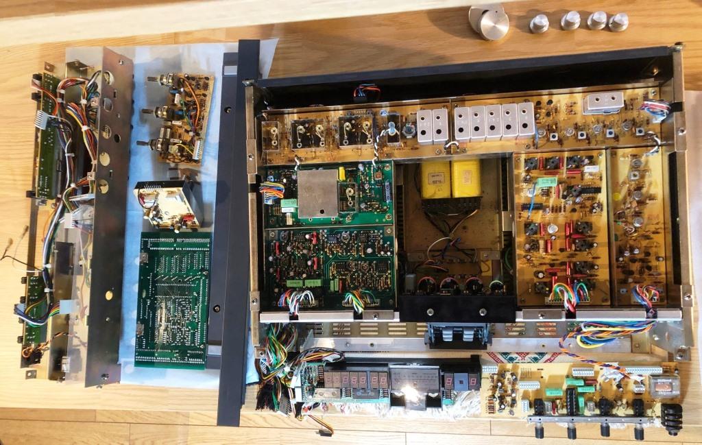

Recently I completed a full restoration, following picture is only a partial disassembly but gives an idea of what’s involved.
Figure 1. B739 Tuner Preamplifier partial disassembly.

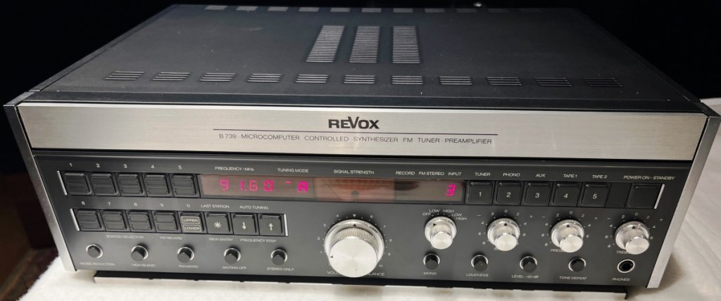

Here's a picture of my B739 FM Tuner Preamplifier after full restoration.
Figure 2. B739 FM Tuner Preamplifier after restoration, powered up and operating.

Thanks, please allow me to explain more about this restoration.
Fortunately, the electronic components were standard items and replacements were not expensive, although it took me several months to test and replace each component one-by-one.
Components replaced:
- 23 electrolytic capacitors (many of these measured out of specification and it was essential to replace them all)
- 68 tantalum capacitors
- 1 suppression capacitor
- 1 resistor
- 4 op-amps
- 1 power supply fuse
- 5 pairs RCA jacks (the contacts had become corroded)
Others:
- As the original Nextel paint had become faded and flaking off, what was expensive with this restoration was having the chassis and panels professionally re-painted at an industrial paint shop.  For a small discount I had all chassis and panels for my vintage ReVox equipment re-painted at the same time; B739 FM Tuner Preamplifier mentioned here, B790 Linatrack turntable in my avatar, and a B710 Cassette Deck currently in restoration progress.
Thank you,
