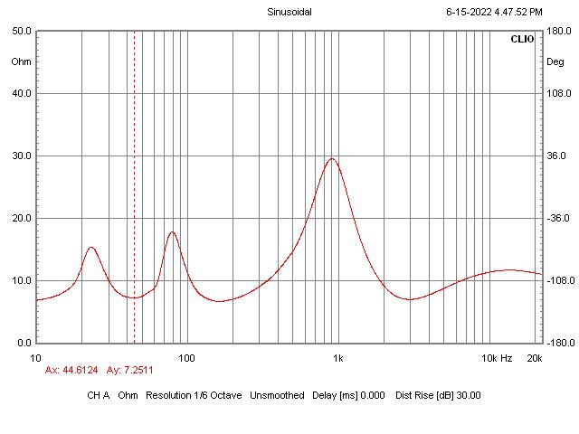

My first thought was, okay, I just need to get some better speakers - these are $200 Polk Tsi200 bookshelf speakers btw. Then I remembered the "sensitivity" doctrine, which states that one of the main things you need to do for a low-power amp is look for higher-sensitivity speakers, so there's enough volume.
Impedance graph: But then I found people online saying, based on their own direct, personal experience, that sensitivity really does not matter very much with a tube amp, and that what really matters is the IMPEDANCE graph, over all the frequencies, and that the impedance not dip down too low anywhere. So what they recommend is first: mostly ignore the "sensitivity" rating, and then secondly, totally ignore the alleged "nominal impedance" and focus instead on the "minimum impedance", or the lowest level that it dips down, and if you must use a tube amp or a SET tube amp, rule out anything where the impedance dips down to 2 or 3 or 4 ohms, and ideally look for something several clicks higher. Here is a useful article I found about this from a website called DHT Rob.
So on this basis, the Encore might be one of the better speakers offered by GR Research for someone worried about impedance dips, because it looks like it dips down to 7.5 Ohms at the lowest. Does that sound right?
However, this is all theory. What I also greatly value is testimony from people's direct, first-hand experience. Can anyone comment on using a tube amp (or a SET tube amp) with Encore speakers?
My first question is: What tube amplifier?
If the amplifier has high output impedance (ie most SE amplifiers, some PP), then the shape of the impedance curve will be added to some extent to the net response. Do note that given OPTs are tapped for nominal impedances, flat impedance is also helpful.
Low impedances needcurrent delivery, harder to do with a tube amp, so higher impedances don’t hurt.
the Encore might be one of the better speakers offered by GR Research for someone worried about impedance dips[/img]
From Danny’s site.
If your tube amlifier has a high Rout then you will hear that big bump at the XO.
Some people even go so far as to suggest that an ideal speaker for a solid-state amp cannot really be excellent for a SET tube amp, and vice versa.
Depends. On the amps and on the speakers. And a bunch of other stuff.

This is the actual impedance of the X-LS
I've updated the page to show the correct impedance graph.
The one in the previous post is the impedance of the X-CS.

The 30Ω 1kHz bump is still there, but now with a reflex impdance at the bottom and not as much rise. Means bass should be less problematic.
(in the case of a high Rout amplifier.

Planet10: The amp I'm using now is called a GemTune X-1. I got it about six years ago for about $260. It has two EL34-type tubes, which I upgraded to JJ brand E34L. The amp supposedly puts out 8 watts per channel; I am not sure what the output impedance is as I can't find my manual for it (if it even came with one! ha). It sounds surprisingly good with acoustic music, to my inexperienced ears anyway. It seems to have plenty of volume 99% of the time with my current cheap Polk TSi200 two-way speakers (rated at 89db sensitivity, and unknown impedance curve) - last time I played a record I turned the volume up to about 11-o'clock and that was plenty loud. I am using the 4-ohm output taps, instead of the 8-ohm taps, which I think lowered the volume, but also lowered the distortion issues. There DOES seem to be distortion sometimes with recordings that have bigger sound, more instruments playing at once. I assume it's because this draws too much current on the tubes.
Here's a comment from one person who allegedly bought this same model of amp: "I am driving NHT VT 2.4 towers. They have 88dB and 6 ohms impedance. They drive them very nicely, fill the room completely. The sound gets loud to the point of annoying neighbours. Personally, I cannot listen to music louder than this. However, if you are the kind of person that wants the music VERY loud, you should try a solid state amplifier with more power..."
I'd be open to upgrading this amp at some point. I do like the tube amp sound with acoustic music.
Ideally I would also like, someday, to figure out how to have a proper, high-quality, high-pass inline filter for the main speakers, since I just got a REL subwoofer. I'm thinking that if the bookshelf speakers are trying to play below 100 or 200Hz, maybe that's wasted electrical current that the amp would rather not spend. I believe this is what Danny Richie said recently in another thread. I guess tube amps simply don't have a lot of current to spend, so things like in-line filters and minimum-impedance speakers both can help to conserve the current, perhaps.
So the crossover is where the impedance curve tends to dip down?
Are the impedance curve spikes an issue for tube amps, or just the dips? Some people online say that SET tube amps want to see flat-impedance-curve speakers. Other people say they just want to see minimum-impedance speakers, meaning, ones with no big dips. I'm totally new to all this, so just learning.

It is SE, typical power is about 5-6 watts in Pentode (maybe UL), output impedance will be high, how high depends on how much feedback they use to lower it. Without feedback an SE pentode is a current amplifier.
Where the volume contril sits is more about how much gain there is in the system, and almost nothign to do with how much power you are using up.
If the Encore is 87 dB, you will run out of juice about 97 dB, at most typical listening levels found in the home it is likely sufficient, but it will clip if you crank it.
