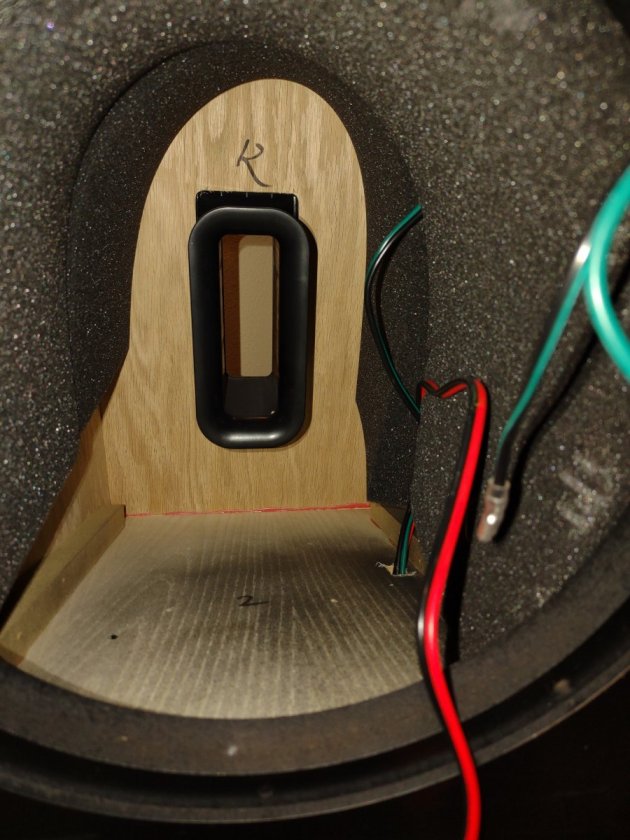

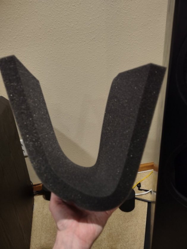

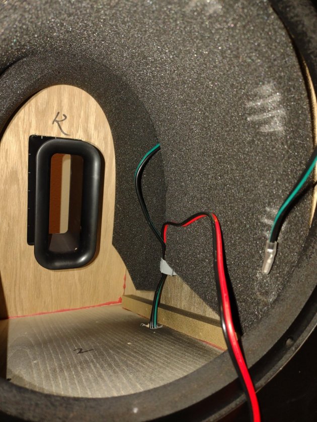

Moving down to the first woofer  three pieces of foam here 1 was turned to a "U" to mask the port, Klipsch port tuning?
« Last Edit: 21 Jan 2023, 02:24 am by oldman74 »

That third piece of foam in the top woofer,
oldman74
Re: RF7-III upgrade
« Reply #9 on: 21 Jan 2023, 02:37 am »
1st
 woofer port exposed

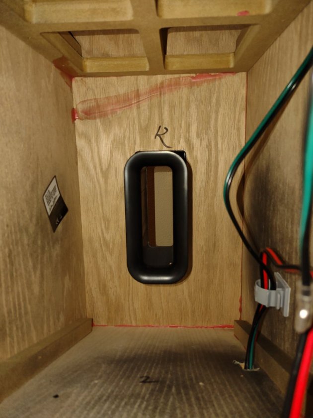

« Reply #10 on: 21 Jan 2023, 02:41 am »
Pulling the rest out of the 1st woofer, you will notice bottom right of 1woofer space hole where wires were held and sealed with what feels like plug\duct seal compound

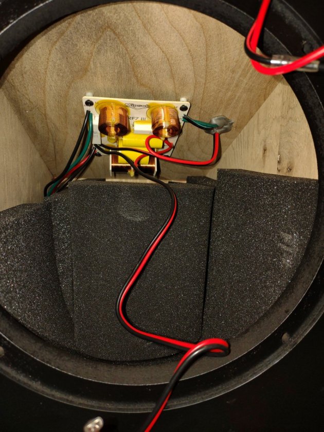

« Reply #11 on: 21 Jan 2023, 03:04 am »

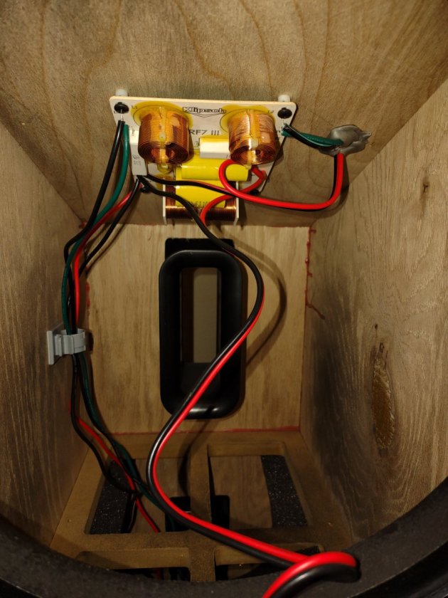

2nd woofer, foam amount are the same, crossover located, and the raceway for the wiring and the duct compound used to seal it.

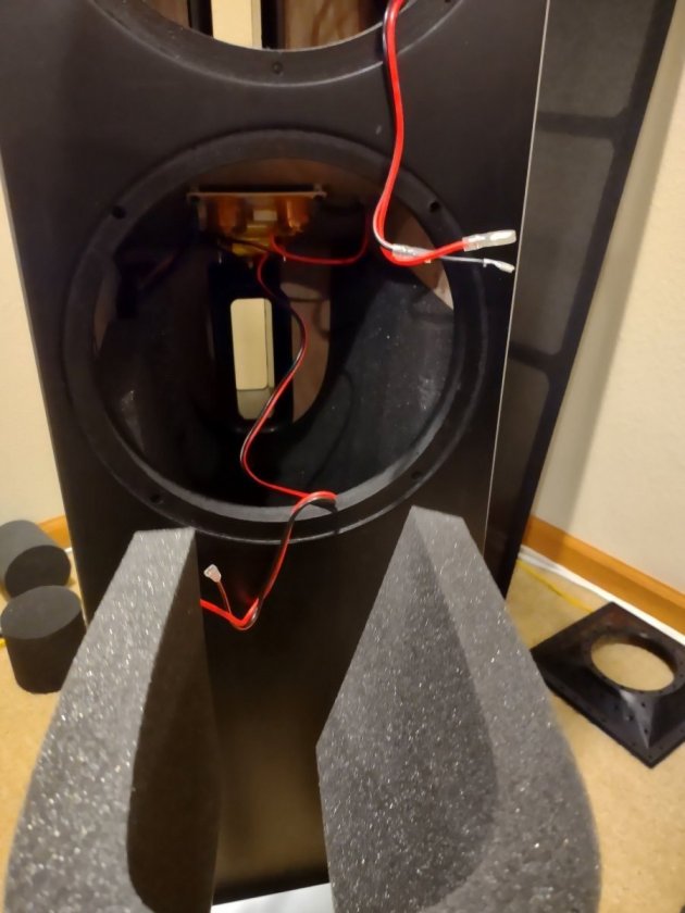

« Reply #12 on: 21 Jan 2023, 03:13 am »
pulling foam and crossover

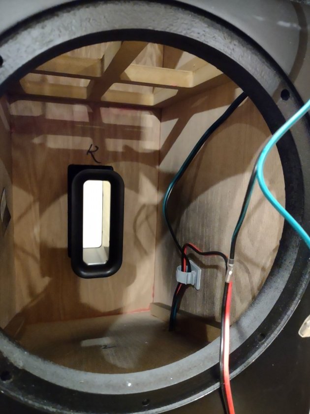

« Reply #13 on: 21 Jan 2023, 03:29 am »
closer look at the binding posts, crossover, all part's pulled except 2 pieces of foam in the very bottom adjacent to the speaker terminals

This speaker has some great potential, but certainly has flaws in its original form.   I think this particular upgrade from Danny is going to be of great benefit to those that go this route.
I'm not going to take any time to pick it apart,  but this is the stock crossover from klipsch, to aid in understanding the starting point for this speaker.
The accomplishments of the replacement GR-Research crossover in taming and balancing the tweeter, and converting to a 2.5 way by crossing the two woofers separately is significant.
For anyone already into the cabinet to upgrade,  adding a few more braces wouldn't be hard. It seems inadequately braced.
