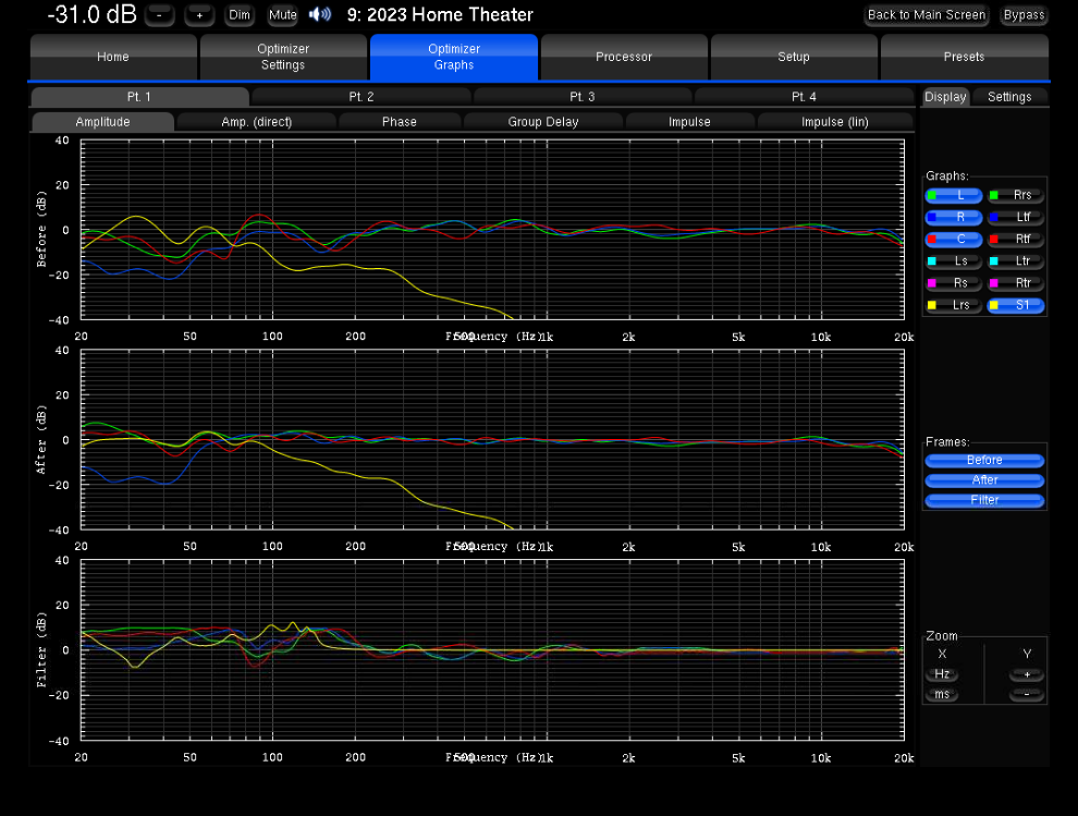

hey yea so oddly I found the issue on the right side and turned the gain from zero all the way up to match the left side to correct the issue.  Now TODAY my left although the gain is all the way up does not appear to be producing any low frequency ... anyone seen this issue before and if so any suggestions?

no its not I had it dialed in perfectly... and if it was my room it would have continued to be my right channel.. this time it was the left.  So in my excitement of turning up the gain on both sides to equal measure what I failed to do once my system was turned off was to turn off the amps in the x3s... this caused a low noise frequency... I think in doing so it reset the level on the amp of my left channel to P3... I am not sure what those p2, p3 etc are...but I put it back to p2 and that lower woofer is now doing its thing again... any suggestions on the amps needing turned off in some sort of automatic solution?..

Thanks I let my Trinnov control the input curves on all my speakers so I think for that part I am good as for as a response.  I found a Trigger switch that I am going to hook up to my system and this should take care of the rumble issue automatically for me.  Thanks gents for all the input these are truly remarkable speakers.
