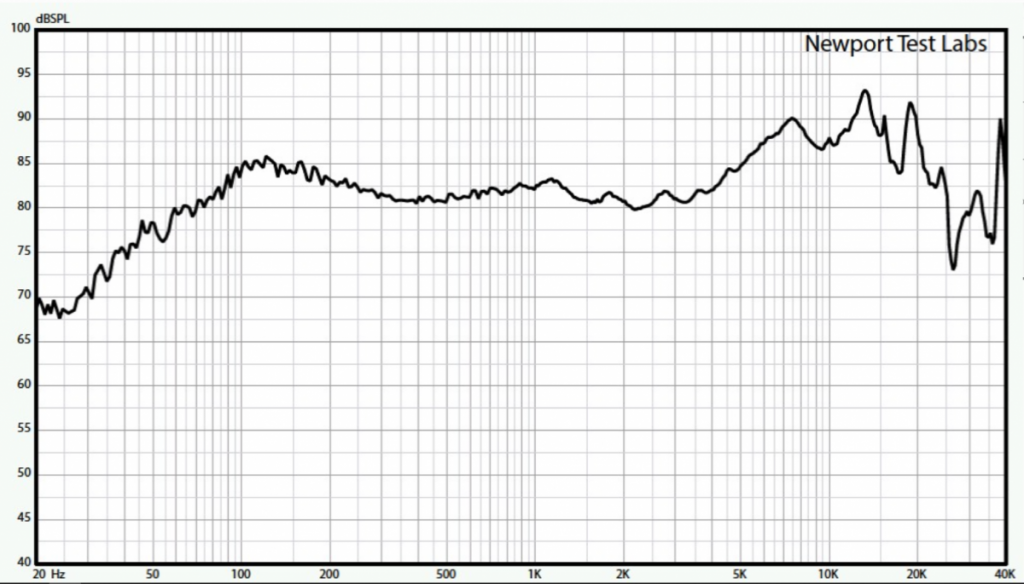

I managed to find some measurements of the Boenicke W5 online from a couple sources, and they definitely have some issues, especially above 4KHz where it rises 10dB before getting into breakup territory starting around 7500Hz, likely involving a lot of ringing at each peak
https://www.pressreader.com/australia/australian-hifi/20170101/281758448922241
The Boenicke will have better bass extension (down to about 55Hz) than the LGK 2.1, but the 2.1 will have a much more balanced overall tone with bass extension down to 70Hz, just a bit less interesting looking of a design.

I've seen these a couple times at shows. Excellent soundstage and imaging but looking at that graph I see why they never toe them in.

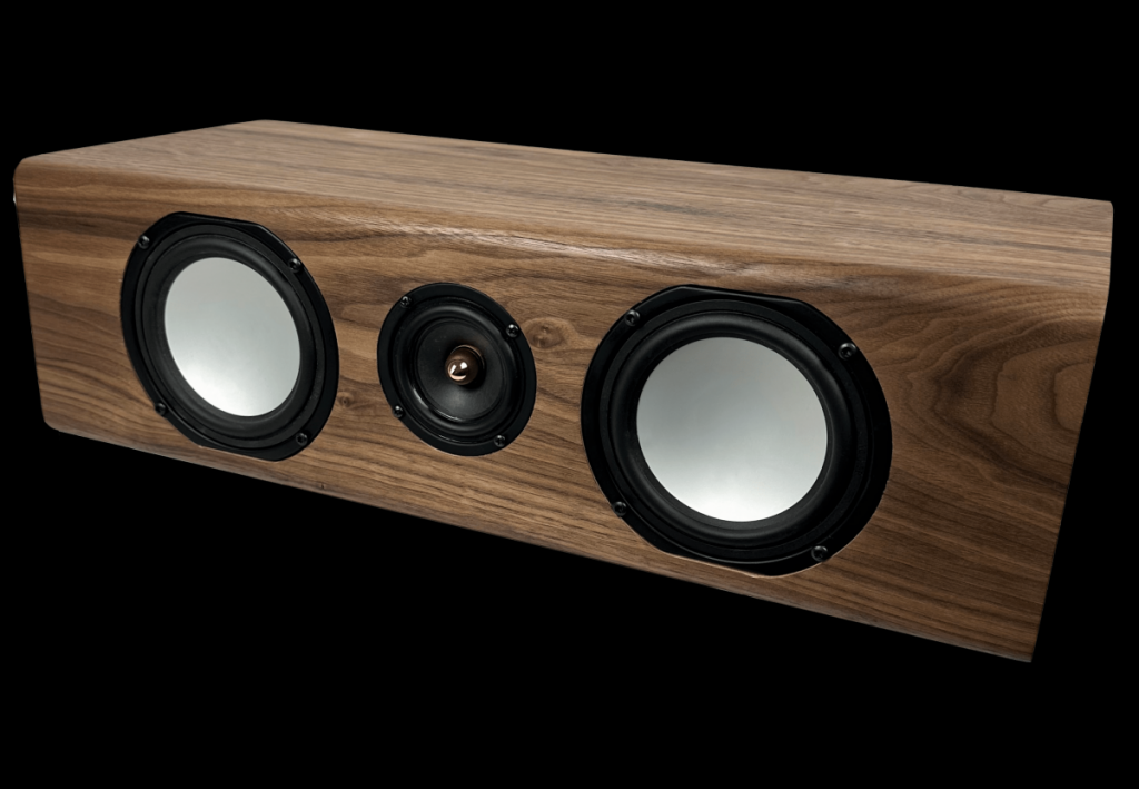

Danny just filmed the video for the 2.2 today, so it should go live in the next week.
Here's one of the pictures used for the website:
The one in the video is painted with duratex to match the 2.1s we built a couple months ago.
It's intended to be the matching center channel to the 2.1 with a woofer on either side of the LGK driver.
It can also be used in pairs as L/R speakers as well.
We don't have a 2.3 planned.
The 2.4 will be the a tower version with 4 woofers below and a single rear-firing LGK.
The initial prototype was essentially a 2.1 but with 4 woofers down below.
We'll be tweaking the cabinet design for the 2.4 to fit the rear driver and get a new test cabinet built as well
