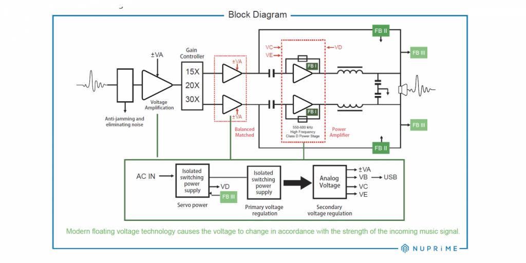

"The $649 STA-100 includes innovations in SMPS that we are introducing for the first time. It is an Adaptive Voltage Switching Power Supply where the amplifier’s output signal feeds back into the power supply’s servo power stage, causing a change in the output voltages supplying the power stage of the amplifier. This design resulted in more details at a low music level and explosive power at a high volume. For more information, refer to the product page: https://nuprimeaudio.com/product/sta-100/"

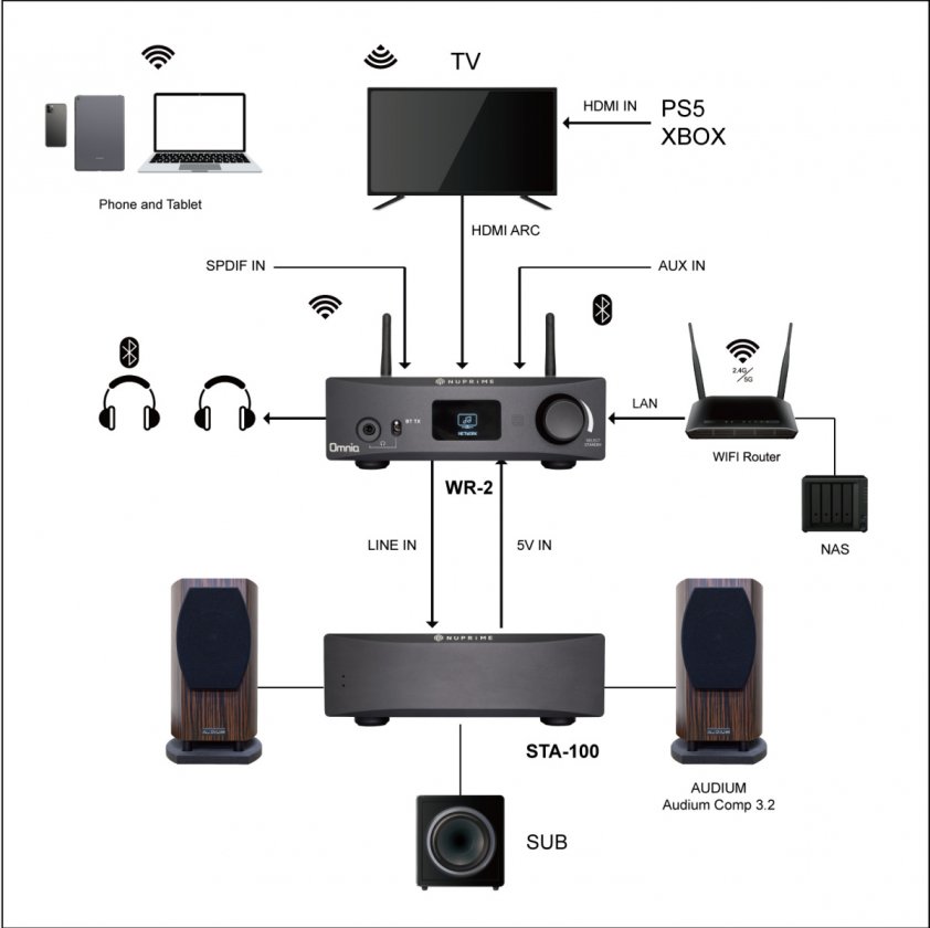

The STA-100 is designed as a "standalone" amp in the < $1k Omnia series. It has a 5V power supply for Streamers (Omnia Stream Mini DAC, WR-2)
The Adaptive Voltage Switching Power Supply is the most innovative SMPS design introduced by NuPrime for the first time. The amplifier’s output signal feeds back into the power supply’s servo power stage, causing a change in the output voltages supplying the power stage of the amplifier. This design resulted in more details at a low music level and explosive power at a high volume.
