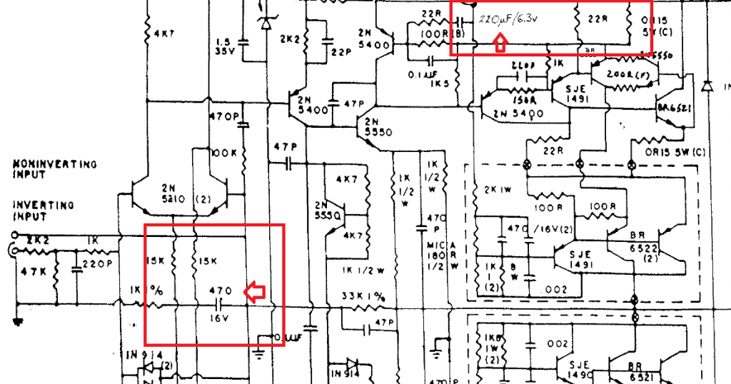

On a related note with the particular model 3B amp I own, I have a question for anyone here who is familiar with the early vintage 3B amps.
I want to also replace some of the aged capacitors on both of the amp boards.
The visual inspection of the capacitors shows two electrolytic values being used as noted below.
Two, 220uf/6.3v per channel that appear to be in series from what I can tell by looking at the component side of the board and one 470uf/16v capacitor.
Is the 470uf/16v capacitor a polarized or non-polarized capacitor.
My question is that from the schematics I was able to source it appears that it may be either a polarized or non-polarized capacitor. I'm not sure which capacitors (polarized or non-polarized) should be used.
I will upload a couple of pics of both schematics to illustrate this.
Any help here would be greatly appreciated.

I just want to confirm a few things before I order some parts as I have never seen an axial polarized capacitor like the one that is pictured below with the arrow, plus sign, and that squiggly design that is after the plus sign.

Okay, I spoke to Mr. Pickett and would like to share his expertise on this particular 3B circuit.
His response was that the 220uF capacitor is a protection circuit timing capacitor. The 220uf/6.3v capacitors carries a small amount of DC voltage and you can use either a polarized or non-polarized capacitor when replacing it.
The 470uF/16v are the feedback capacitors in this design and it sees no offset at all. That capacitor can also be polarized or non-polarized capacitor too. Mike also made it clear that if you use a polarized capacitor, its orientation is not critical.
According to Mr. Pickett, Bryston has tested non-polarized capacitors in both positions for the 3B amplifier and noticed no change in performance or behavior but they tend to use polarized for both circuit positions to this day.

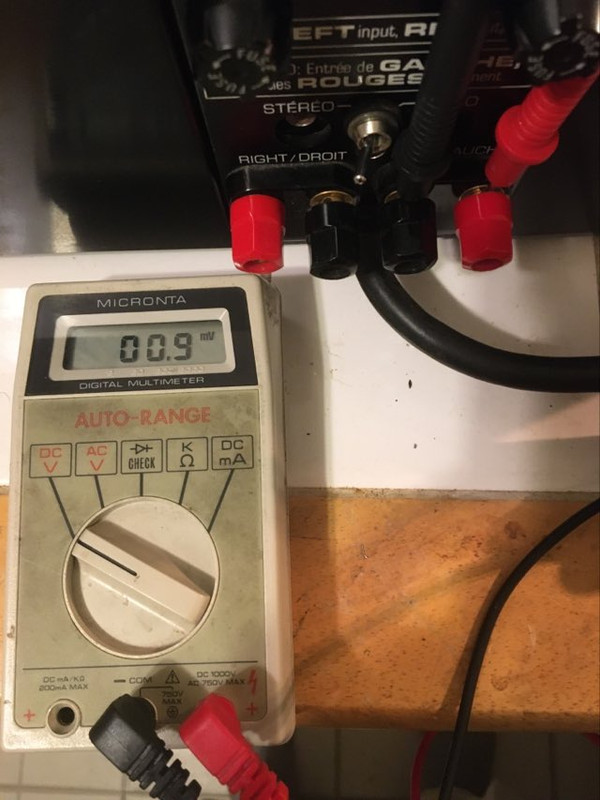

Hi all.
Well here's an update on my 3B amplifier.
My 40 year old 3B amplifier had a lot of things going on with it that was wrong. High DC offset and unstable bias. First problem addressed was a couple of bad output transistors. Bought a total of 16 Onsemi BJT power transistors (8-PNP and 8-NPN).
Replaced all 8 power transistors (4 for each channel) and matched each channel as close as possible using a TRL/LCR/ESR tester.  Powered up the 3B on a Dim-bulb tester and no problems were observed.
Next I tackled the high DC offset. I very carefully de-soldered and replaced the 8 small BJT transistors for 4 for each channel each channel. These transistors need to be very carefully matched and the TRL/LCR/ESR tester was not suitable for the task. I ended up buying about 20 pieces each for type needed to do a full replacement. So I sourced the various needed parts from Digi-key. I also replaced just about every other BJT transistors in this amp with the exception of just two. The majority ofthe BJT transistors were way out of spec. So I replaced them. I even did the 4 BJT's on the small input board too. I also replaced the two antique 10K bias trimmer pots with new ones from Bourns and all capacitors except the big AC mains filtering caps.
My next step was to figure out how I was going to match the critical pairs of BJT's correctly. I found a video on YouTube where some fellow made a transistor tester from a few parts and a dual 15 volt transformer. That seemed like the way to go, but as I was searching and researching things I inadvertently stumbled on a Ebay seller from Thailand.  The seller was offering fully assembled and DIY curve tracer kits that simply used an oscilloscope.
So I purchased the $28 kit plus shipping and 10 days later my kit arrived. I quickly assembled it (you need to have two 15 volt power supplies. I have an analog scope and a dual channel regulated power supply) and hooked it up to my oscilloscope and that little curve tracer kit worked fantastically in helping me get perfectly matched sets of differential pairs.
So here's where I'm at right now.
The 3B is powered up but without the 8 power transistors installed. The DC offset is now perfect at 00.1 mv and 00.9 mv (see pics below) and I'm letting it burn in for a day or two to verify that everything is good. I will then install the power transistors and bring the amp back up on the Dim-bulb tester at first and if all is well then I will adjust the bias trimmers and reintroduce the amp into my system and report back on how things sound.
