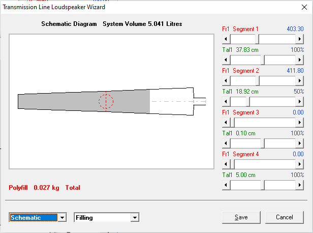

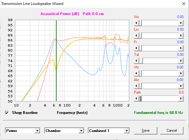

Update on LGK 2.0 TL project: I've managed to package the same response as the TL above in a speaker that is almost identical to existing LGK 2.0 reflex speaker footprint. It is 3" taller, but you get an extra 1/4 octave bass for that along with improved power handling. The port is as small as I dare go, while keeping velocity below 10m/s at maximum power. The smaller cabinet means that the driver will damp TL more. So stuffing density up to port entrance will be reduced from above, with Hornresp showing 18g acrylic fibre fill as the starting point. As Danny has constructively commented this risks allowing some HF cabinet modes to remain undamped. I have used the same tricks as above with driver positioning to avoid 3/4 wave mode and TL depth to avoid 5/4 wave mode. To be sure about no HF leakage I recommend increasing the stuffing density above the BSC filter to just below the driver. This appears to have almost no influence on the 1/4 wave mode but will help absorb HF. Again BSC filter will need a trap door in the base of the cabinet.
Problem now is logistics, as I'm based in the UK so making the speaker pair then shipping them to US seems counter intuitive. I'm waiting for a rough estimate on the above design from Killian, so that will help me to decide next actions...
Mart
Analysis done in metrical, but designed in steam units to assist manufacture.
Flare at location "S5" input into Hornresp with constant port area and a small length correction.
This is at 1W input power.
This is at maximum power (assuming the new LGK 2.0 xmax of 2mm).
« Last Edit: 20 Nov 2022, 04:01 pm by Martin Garrish »

A BR with a high aspect ratio vent that adds R to the vent. If you got the alignment right you have just designed a miniOnken for this little FR.
A proper TL will more bass potential.

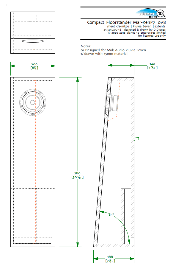

That is the original… since then we have done literally 100s of miniOnkens designs for a wide swatch of drivers.
It is a specific alignment that uses the highR vents to create a box pushed towards aperiodic that is more tolerant of changes in T/S due to dynamics (or how high the wick is turned), they have very elegant, detailed, articulate bass, but they only go as low as they go, and typically a smaller enclosure.
Your impedance curve is very similar to that of the original FonkenPrime.
There is more history here: https://www.diyaudio.com/community/threads/fonken-style-box-nomenclature-what-is-with-those-names.160747/'
The classic boxes have the vents running down the sides, but the Classic Golden Ratio and more specifically the Compact Floorstander, have the same shape as yours, but stretched out to be a floorstander.
I might get in some triuble posting this link, it will give you an idea of how widely applicable this alignment is: https://www.diyaudio.com/community/threads/planet10-hifi-minionken-plan-set-subscriptions.186350/page-8#post-7034792

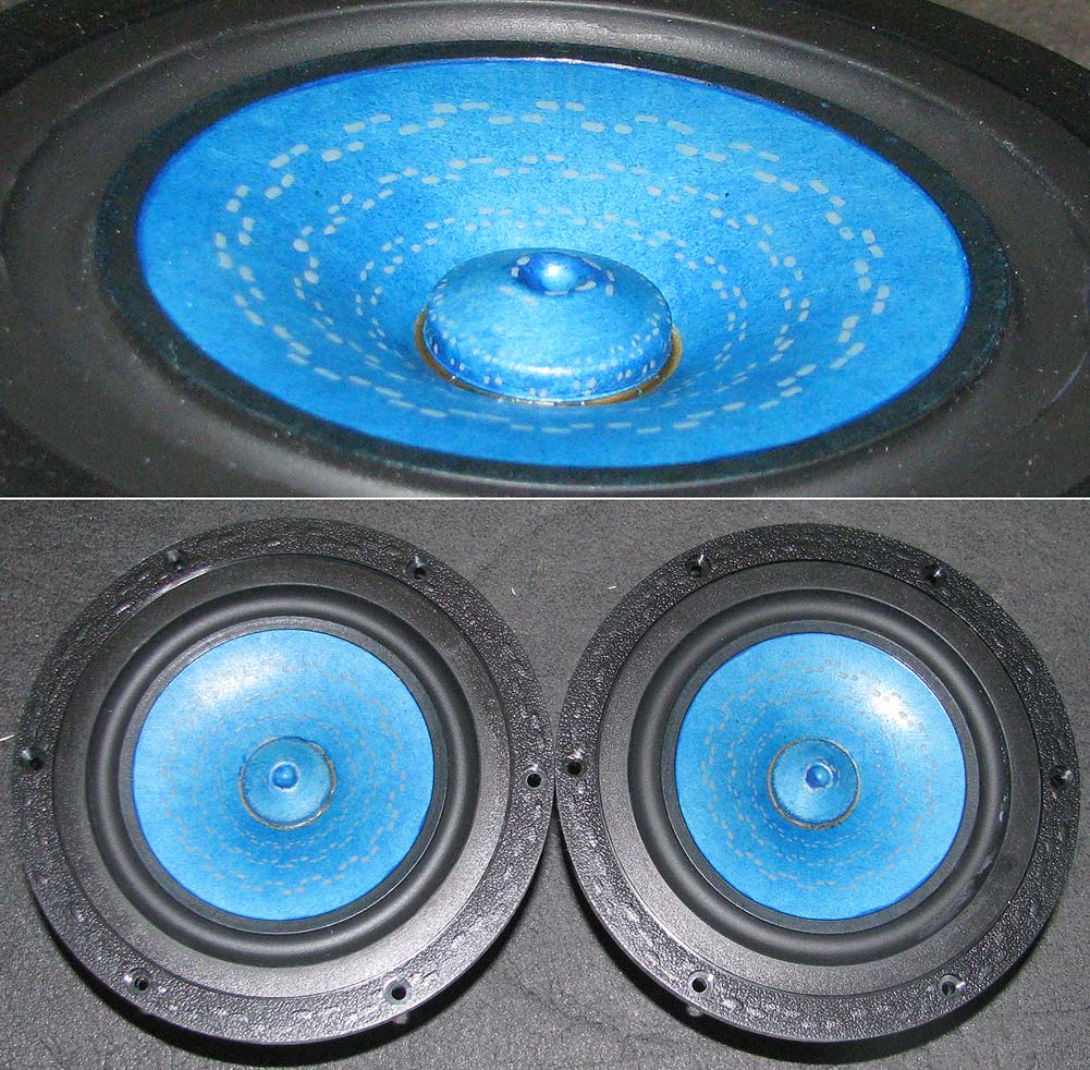

I have also been tweaking drivers since the late 70s, and this culminated in EnABL. Sadly no more. Most drivers have other pre-EnABL tweaks.

I read the white paper on EnABL, so wanted to check my understanding. The EnABL process is adhering stiff membranes onto flexible surfaces, like cones and baffles, to diffuse the flexural wave by providing half wave cancellation as the wave passes through. So it is effectively providing termination impedance in a manner similar to a 1/4 wave TL stub for absorbing a particular frequency. Is that a fair summary? How does it compare to soaking paper cones in silicon fluid to absorb the flexural wave? I really have found nothing that sounds better, especially if you treat the spiders too. In fact before I found silicon fluid I actually did write off some FR drivers by soaking them in honey and golden syrup! It works for about 24 hours then the honey dries up.  :duh:
Nothing really adds stiffness, and it is still anyone’s guess as to how or why it works. We did discover, with gen 2 EnABL, that the rings fall right on top of where the transition from one defining curve to the next (this by talking with the designer, and the cone being made from a number of curves blended together into the cone shape),

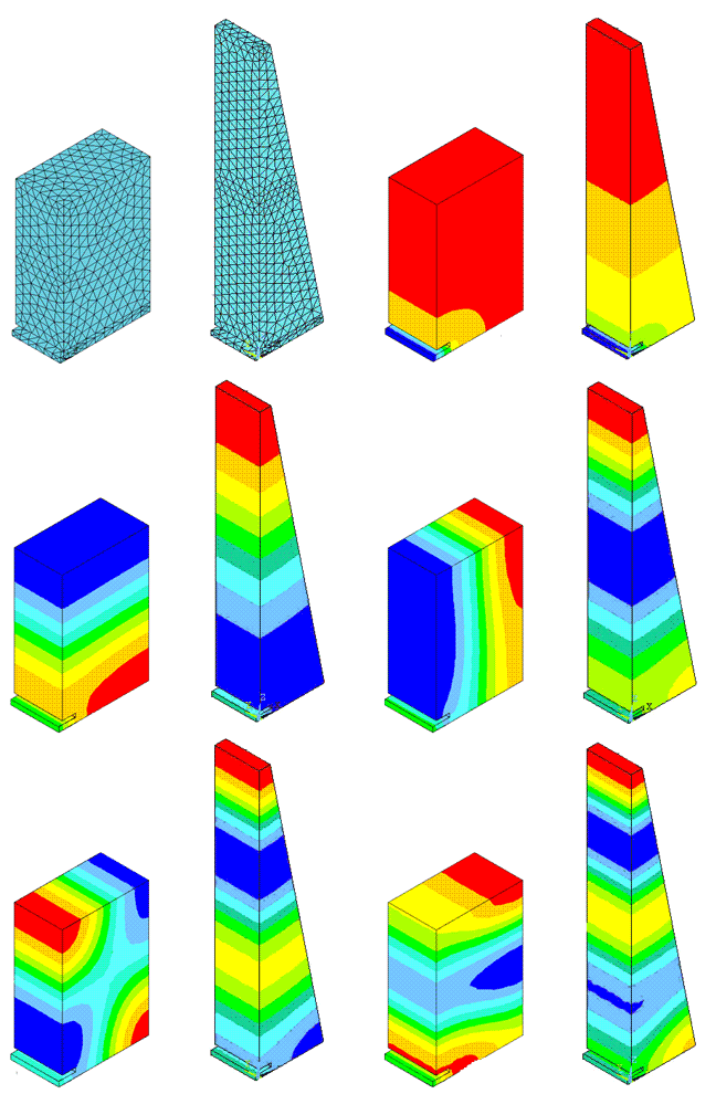

Using Ansys multi-physics on this project would take up a little too much time! I'm confident David McBean spends many hours thinking about how to improve Hornresp. I should join your diyAudio forum to learn a little more from his thread!
The rear port came about as I found that there actually needs to be a time delay to stop TL output cancelling driver output at 800Hz. It was a thread on your forum that taught me that trick. In reality this may be an artefact of a 1D calculation to a 3D problem, but it also packages better.
You are quite right about the deflectors though. They are really there to give me confidence that the 1D Hornresp software will produce credible results for a 3D problem (they also help avoid aerodynamic flow boundary layer separation at the line corners too). When looking at Danny's original design I put in a "horn element" that had ~0 length. Hornresp can do 0D bass reflex calculations, but my objective was to understand the 1D design rules for TL. Actually, I like the idea that the final design will probably be very similar to the original GR-Research offering, but with the port repositioned and overall cabinet repackaged to optimise 1/4 wave and cancel 3/4 & 5/4 waves. Convergent ideas tend to be the right solution to a problem...

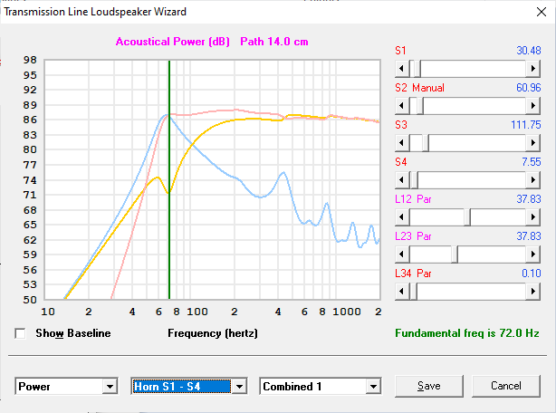

To simulate a front port, this is Hornresp output with no port output delay (in red) with original left in for comparison (in grey). This is really an artefact of 1D code assuming uniform excitation of the line cross section. Truthfully, the driver will decouple above the 1/4 wave cross section depth of the line, because it is off to one side. But rear port seemed a sensible fix and actually packages better.
Mart

We tested the EnABL'ed process on some of our M-130 woofers. They were sent to us completely done.
We were not about to find any measurable or audible differences in anyway.
I also would not recommend trying things like that on the LGK cone. There is no telling what the result might be if there is any difference at all. The lightly painted dots really doesn't do anything, but a heavier doping on the cone will alter the response and output level.
Do you have a picture Danny.
I do have some measurements that show difference, bu tAFAIC it is open to interpretation.
I strongly sispect that what you measured is not what EnABL does.
dave
