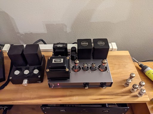

viggen
Hi.
I have an opportunity to buy a tube rectified EL84 based tube amp with 4 wpc.  It has Tango transformers and made in Japan.  So, it has 100v and AFAIK 60hz power input.
Seller says he could install a resistor to step down in lieu of a step down transformer.
Is this safe with a tube amp?  Seller says only downside is the resistor will produce some heat.
Thanks.

Japan have both 50Hz and 60Hz.
If the resistor goes out the amp will receive full 120V.
The correct is rewind the power transformer primary wind to 120V using the original core, its not a rocket science job.

   Wait! A power resistor at the 120V input to step down to 100V? I've never heard anyone doing that. First off you'll need a very high power resistor to do that and likely have to deal with heat.
    Honestly the easiest way and safer way is to get a good step-down 120V-100V transformer. Just make sure is rated at least twice the max power consumption of the amp.
   Another way to look at is to see if the the main power transformer can be rewired to 120V. Many main power transformers have multiple voltage input, even though they don't say it on the outside of the components.

Wow these are quality irons. This Tango trafo can be rewind easy.
If the amp are low priced and was made with Hard Wiring Poin to Point it worth the hassle.
