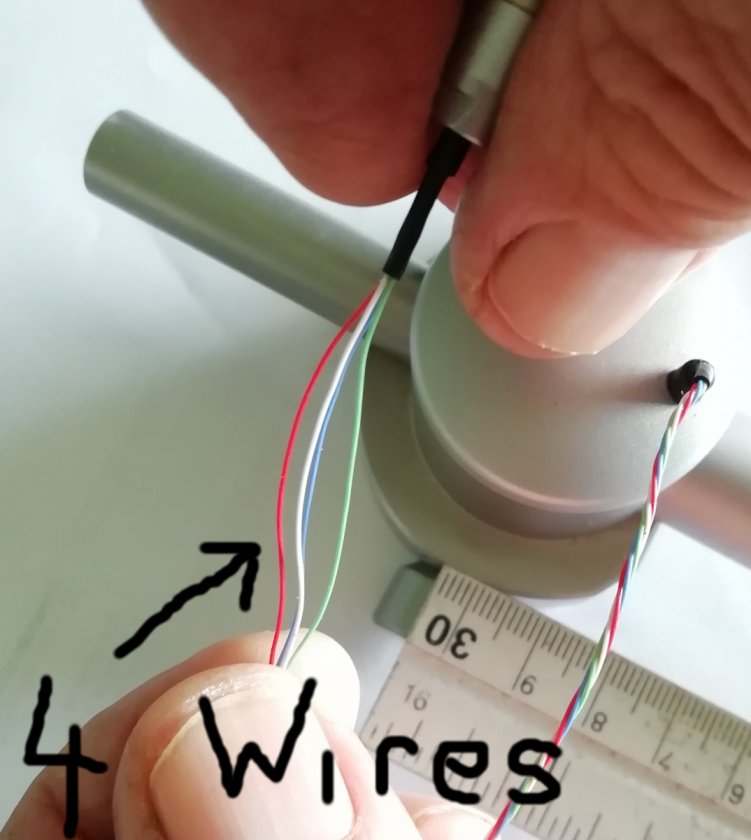

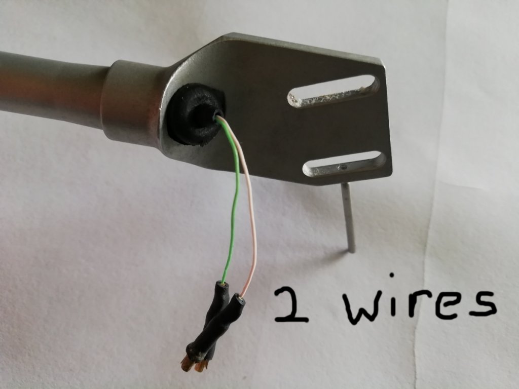

Hi, Has anyone ever rewired one of this arms, I have accidentally snagged two of the wires & broken them somewhere in the arm tube. But the remaining two wires will not allow the rear wire to pull through.

Hi Guys, Thanks but no tanks, I can do this sort of thing my self, after all I make 12'' tonearms. Just looking for some pointers, but I think I have found a way in.

Hi Guy's, just to you know I have now managed to repair these wires. Boy it was not easy, VPI wire is a pig of a wire to solder.
Used VDH wire for repair, very easy to solder.
Cheers

Yes, The VPI is deliberately engineers so ''Joe Regular'' definitely could not do it.
Whereas I deliberately designed my arm so the wire can be changed without special tools & it takes about 5 minutes after the loom is made up.
