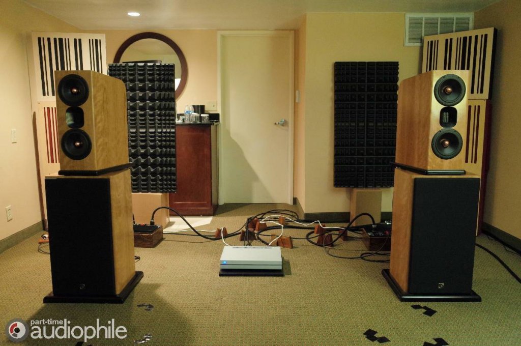

I just recently completed the XLS Encore’s, I am also looking to up-grade my subs. The Double Trouble kit should work well, however I would like to set the Encore’s on top of the subs, I plan on using an isolation product to decouple the two speakers. I saw this configuration on NRD when Ron was reviewing them. Is this recommended or can it cause issues or limit performance? The speakers currently sit 55” from the wall opposite my listening position and 36” from the side wall. I did search but did not find the answer.

I use them for NX Studio stands and put Isolate it Pads underneath the speakers.
  • Posts: 11649
Re: Using the Double Trouble’s as speaker stands?
« Reply #2 on: 26 Oct 2022, 03:11 pm »
Any footer made of sorbothane should work well.

So long as you isolate the speaker from the subs you're in great shape.
I have my NX-Studios sitting on a pair of older dual 8" U-Frame subs, and it's been working out great, and the dual 12s will only be even more impressive.
There's nothing that stands out as something to be concerned about.

I had this several years ago.  It was a good combo.  I used Isoacoustics ISO-155 stands for isolation.  Also Isoacoustics Modular stands custom cut for my subs.

These are mine. I have Herbie's fat dots between the monitors and subs
Mike

Those are beautiful!!!
