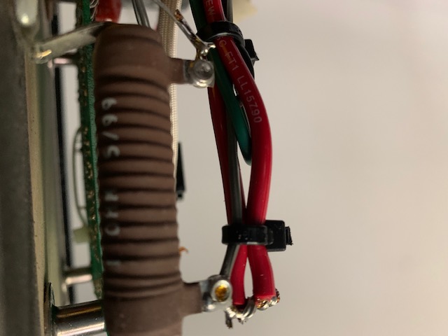

Is matching the DCR and inductance for the drivers involved, or is there another reason? The crossover uses different resistors then I am accustomed to seeing, pic included. They are 1ohm 20 watt buggers. Do I need to use another 20 watt resistor, or will a 12 watt Mills for instance work and not cause problems? Thanks.

Inductance is the value of what an inductor does. If you don't match it you'll turn the speaker into a joke. The DCR is the base resistance that 100% of frequencies see (the inductance changes the impedance based on frequency but it's impedance+DCR always). Think of it like this, the DCR is a resistor in series with the inductance but it's all the same part. If your current inductor has .5 DCR and you move to a .1 DCR then you need a .4 resistor inline with it or you'll have changed the volume for part of the crossover.

Thank You Folsom, I understand a little better now. I've decided to not change the inductors and just replace the caps and resistors. Replacing the inductors and what is involved may be above my pay grade. :lol: I've also decided to make the xover outboard so I can accommodate the new larger parts and arrange the inductors so they do not interact with each other.
