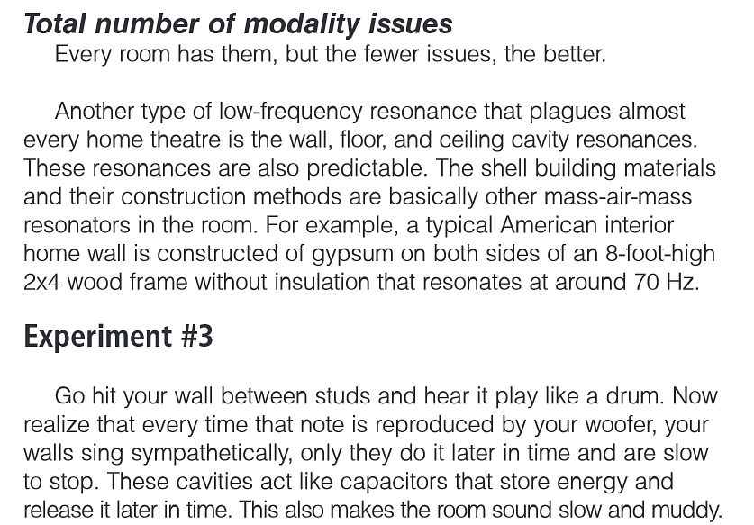

Interesting idea, there may be some answers in the 46 articles written by A/V Room Services
https://avroomservice.com/articles/
It’s All In The Acoustic Details
Part III: Bass Resonance
You wouldn't want to accidentally make a drum.
