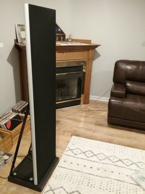

Built stands for 1.7i s
« on: 24 Oct 2022, 03:53 pm »
Audiobliss has a topic here for similar stands but I posted new to update.
So, dont try this at home unless your patient, have time, skilled with wood and metal.
Lucky to have a friend make the steel braces, but it took alot of measuring and remeasuring to align things.
Cost was about $80.00 and MULTIPLE trips to 4 different hardware stores. Glad I did not order online as I returned many wrong size parts.
Hope pix come through.

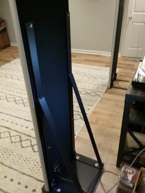

Sorry pix are sideways and not super clear, old cheap phone.
Those are T nuts used in reverse on the cross wood braces under fabric. Had to custum cut rubber spacers between metal braces and speaker for isolation.
 It was very difficult to align holes on braces with Tnuts. Scarey drilling pilot holes for Tnut screws, but time and patients prevailed.
The new stands add ALOT of weight, maybe 25 lbs each. At least their on vinyl floor, so they slide pretty well on felt pad feet.
About 90% done with 2nd stand then Ill critque if any sound improvement as some claim.

Looks like the finished one is tilted back a little, or is that just an odd camera angle?
BikeFi10
  • Posts: 176
Re: Built stands for 1.7i s
« Reply #3 on: 28 Oct 2022, 05:12 pm »
It is 90 degrees, just a bad camera angle. I actually had them tilted slightly forward with the old stands, but Id have to add weights on back with new stands as they might fall forward. Wife was sitting in sweet spot when I tilted them forward with old stands and said "that sounds better" .

Audiobliss, yes project took much longer than expected. Just had many other things going on. Unfortuneately I could not use original stand holes as plate around fuse & terminals was in the way. Took much extra time measuring, drilling, mounting  8 extra Tnuts. As you see I used your idea with the set back to prevent forward fall. I think it looks fine with black, less noticeable. I may still blacken bolt heads.
