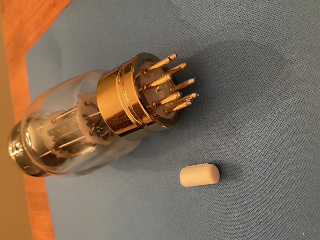

Well, I did it this time.  :(  I was just a bit too aggressive with this tube.  :nono: I'll be more gentle in the future.

It's a Shuguang WE6SN7.... :(  I can still see which direction the ceramic plug faced, so I think I ought to be able to use it (unless someone more knowledgeable warns me otherwise??).

Are you in the PNW right now or overseas? Ah, the 6sn7… I’m running Raytheons on my wonderful Supratek Chardonnay. I’m assuming you can still use it, but hopefully someone else will chime in. I don’t want to be responsible for a lightning show in your listening room ⚡️ 😳

Don't know if you thought of it, but I would put a small, but visible scratch into the metal base to mark the direction where the broken off middle plug was pointing.
Nevertheless, it will remain a small risk but that's life ...

You can get an octal tube key replacement from Tubedepot and elsewhere for less than 10 bucks and avoid inserting it the wrong way.

Good advice! Thank you, both.
