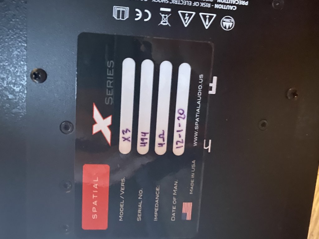

I've been deep in the headphone end of the audiophile pool for a decade now, and I finally took the plunge into 2 channel.  Purchased a pair of early 2021 vintage x3's from a reputable dealer in texas and took delivery of them today.
To my surprise I found 3 caps in parallel going into the AMT driver.  They are laid out kind of messy and slightly different on each speaker, but the solder connections looked like they survived any bumps on the road so I went ahead with setup.  Maybe I'm just an idiot and never noticed them while drooling over posts and reviews.
Get everything set up.  singxer i2s bridge> Audio-gd NOS-11 dac-preamp> First Watt J2> X3 8).  First test track thoroughly underwhelmed :|.
I go back to tweek the sub when I get a good look at the sticker on the back with date, serial number, impedance; they are clearly listed as 4 ohms.  Has anyone heard of Spatial Audio selling 4 ohm variants on request?  How about adding extra caps to the AMT, i can make out a 1 uf and .01 uf but the physically largest cap is blank or mounted with text facing inward.  Dunland tinned copper and Vcap, so no complaints about quality.
I'm fairly upset right now, strongly considering returning the speakers, maybe trying to get the dealer to pay shipping costs.  I'm running an amp particularly good at higher impedance loads, I'm definitely not happy to get some odd lower impedance variant.  Also it looks like the sticker on the back of each plate amp was peeled back to a screw, leading me to believe the speakers previous owner may have had a go at the crossover also.
Should I be upset? What would you do?

Hard to understand a dealer that would not disclose that they were 4 ohm… :nono:
Suggest you call Clayton and ask him if he ever made a pair of 4 ohm X’s…and if not and you keep them they may prove to be a hard to resell unicorn.

My X3’s were also marked as 4ohms. The consensus at the time was that they were mislabeled at the factory. But now, another pair?
Mine also sounded quite poor but no signs of any modifications.

If you keep them, send pics of suspected modifications to Clayton to confirm if they are correct parts.
He can help you restore it back to stock if desired, but mods aren't always bad. They are usually just upgrade parts of nominal size, but the modification technique might be improved. 3 caps in series doesn't make sense to me.
You can use Dayton DATS to measure the impedance accurately.
Impedance is variable with frequency on all speakers. Low impedance dips are OK if the amp can handle it.

I have three X3s, ordered, constructed and delivered from Spatial Audio Lab in 2021.  Two were delivered mid May, 2021.  The third one was delivered August, 2021.  All three say 8 Ohms.  There are two wires attached to the underside of the AMT driver, two wires attached to the underside of the mid-Range driver and two wires attached to the underside of the subwoofer.  All wires are hidden inside except for the short amount exposed showing attachment to each driver.  There are no visible crossover parts.
Me?  I would suspect aftermarket mods.

My understanding is the tweeter from the factory should only have one 3.9 uf capacitor so it seems these speakers have been modified.
Since OP reports 3 caps in parallel, 0.01 uF and 1 uF and the largest cap of unknown uF, one can hazard a guess.
If original cap is supposed to be 3.9 uF, somebody probably "upgraded" that cap with the 1 uF plus unknown (likely 3 uF).  He then probably added the 0.01 uF as bypass.
Either case, I would take good photos of the "upgrade" (hopefully the entire crossover board) and send them to Spatial to review and comment.

STM the original owner custom ordered it 4Ω.

  Since I am the original owner of these speakers, I thought I would make a post to clear things up.
These speakers are 8 ohms, they were mislabeled by one of the employees at Spatial. I know
of other pairs that were mislabeled the same way. One person that had a pair labeled this way called Clayton
and he verified that there was no 4 ohm version.
  A couple of people I know had received X5s and they wanted to experiment with different caps for
the AMT. So SPATIAL mounted the 3.9 MFD cap on the back of of the baffle instead of inside out of view.
I had mine built the same way. The original cap is in the circuit as designed.
I added two bypass caps, a .1 MFD and a .01 mfd parallel to the original 3.9 mfd.
This gives a total capacitance of 4.01 mfd a small difference from the original 3.9 mfd.
I found this to improve air and detail in the highs a little.
If these are removed the speakers would be exactly stock.
Hope this clears things up.
