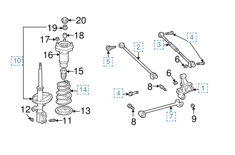

no cv joint since its FWD
looking at the diagram, you have all kinds of possible noise makers. good news is none of them are ball joints
My guess is its going to be 7 but 2 and 3 are possible along with the top of the strut mount 16
