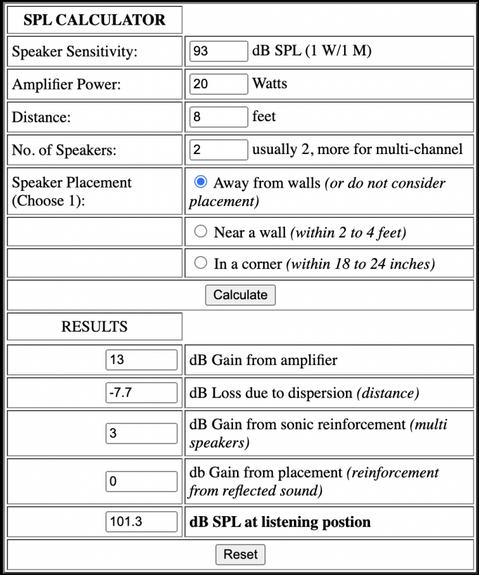

If you run the numbers, a 20 watt amp that is stable down to 3Ω should be more than sufficient to drive perfect bass reproduction in a passive Spatial Audio loudspeaker, the X4 or M3 Sapphire for example. This assumes you are sitting 8 feet from the speakers, they are 93 dB efficient, and they are far enough from room boundaries to minimize issues (e.g, see below).
However, people report getting better bass (in some way or another) with high power amps with their Sapphires or X4s. I am curious about technical insights regarding why this might be.

https://myhometheater.homestead.com/splcalculator.html

Your calc is correct and in a large room I only drove a Pass X250.8 out of class A twice and it was just to see how loud it would be. Needless to say the answer was too loud.

NewZoo - wondering how the calculator you reference deals with frequency differences or is that question meaningless? Isn't it true that lower frequencies require higher current to produce any given SPL (than mid/upper frequencies)?  Don't know how the calculator deals with the issue. But unless the many reviewers, and here I'll reference Orchard's site, are delusional or biased, there are too many reports of increased/enhanced bass, clarity, etc. (attributed to design? power output? circuit execution?).  I thought that with the 92dB M3's power above my 50 watt class A 845's would be superfluous, i.e., no discernable sonic difference.  That is clearly not the case.   Again, amp design? execution? I lack the engineering experience or education to comment let alone conclude.  But that the "more powerful" amps brought something new and highly desirable to the party (even if slight trade-offs say in harmonic bloom or spatial presentation) is, for me, no longer subject to dispute.  Seems like something is going on here.
