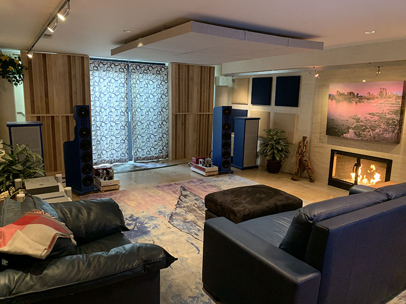

When I first set up my room, I was using GIK Absorber/Diffusors behind the speakers - like these: https://gikacoustics.com/product/impression-6inch-bass-trap-diffusor-absorber/. But I felt the sound was deader than I wanted.
I replaced the GIK panels with QRD diffusors from ATS Acoustics. Wow, what a difference these made. The sound is now much more open and airy with a deeper sound stage and more precise imaging.

I have my diffusors positioned a couple inches in front of my front wall since I have windows and curtains that I am "hiding", so I wanted something that I did not have to mount to the wall. The ATS diffusors are made from wood and are very sturdy. Also more expensive  :cry: unfortunately.
Here's my front wall without curtains or current acoustic treatments.
And here's what it looks like now with the diffusors.

« Reply #18 on: 23 Aug 2022, 03:45 am »
Wow!
 :bowdown: :bowdown:
That looks like the acoustics should be MUCH better! Well done! Hope there has been a noticeable improvement.

« Reply #19 on: 23 Aug 2022, 04:16 am »
Wow!
 :bowdown: :bowdown:
Oh, yeah!
