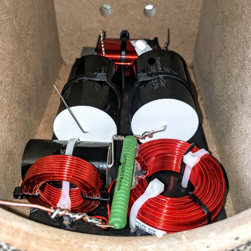

The first pair of LGK 2.1s are up and playing!
(a little too late to crank them though..) :P

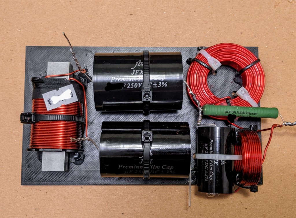

Here's the crossover layout which takes up the entire bottom of the speaker, with Just enough clearance for the woofer :thumb:
More info to follow shortly!  :thumb:

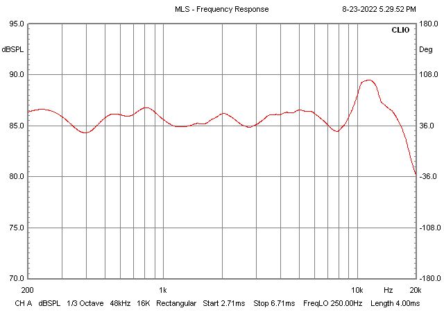

They've turned out great!
Taking the bass frequencies off of the LGK driver really helped to open up the midrange performance. So vocals and strings sound fantastic.
It also allows you to push the speaker a lot further/louder than the LGK 2.0 alone, so they're better suited for larger rooms, even without a sub.
The bass on the 2.1 isn't quite as detailed, but being able to push it further and having a more gradual roll off is a fair trade-off, plus it also allows for near-wall placement and easy integration with a subwoofer without the need for a high-pass filter.
Here's the On-Axis response.
If you find the very top end to be a little bright, towing them out to roughly 10° will help to soften it quite a bit. I personally didn't have a problem with it.
Addressing it with a notch filter, like on the 2.0, would have required a larger cabinet, or using two separate boards, as it's already a tight fit as it is.

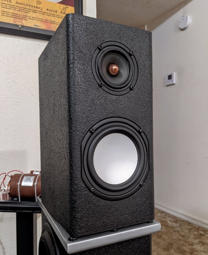

Question on the 2.1 finished cabinets, are the sides rounded off or straight-edged?
Hobbsmeerkat
  • Posts: 2741
Re: LGK 2.1 Sneak peak
« Reply #14 on: 17 Sep 2022, 08:56 pm »
They are rounded over.

Thanks, thinking about purchasing these so I can replace the LGK drivers I have been using at my computer in tandom with a pair of tb mini subs... I want to try something else with them. But i dont really like the color difference between the white woofer with the copper LGK. Would a foam ring with fabric glued around for a woofer cover impact the sound that much?
Danny Richie
« Reply #16 on: 21 Sep 2022, 04:45 pm »
If done properly a grill could be added.

First, right out of the blocks, I'm ducking. So why am I ducking?
The image of the cabinet, it's tempting to look at that, as an open baffle (ala NX Studio monitors) option with no lid.
There I said it, duck, duck duck...
 :popcorn:
Bob
And just because I love the look
Danny Richie
« Reply #18 on: 6 Oct 2022, 08:40 pm »
We may try some open baffle versions of it next.

Finally was able to finish up my LGK 2.1s last weekend. Kudos to Killian for sending me beautifully veneered cabinets in Walnut. After a week of break in, these speakers have a midrange to die for. One of the most natural sounding speakers I’ve heard. I love them. They are perfect for a bedroom speaker. The only thing I did differently from how it comes is I added Duelund JDM pure copper foil bypass caps on the 2 caps in the signal path. There is still much more break in needed and i can tell these are probably never coming out of my bedroom system.
