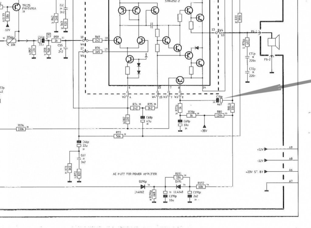

If you used the 4.7uf capacitor then you could be drastically changing the crossover point depending on where that cap is in the circuit.
If you tell me more about the speaker and show the schematic then I could try to tell you what would change if you use the 4.7uf cap.

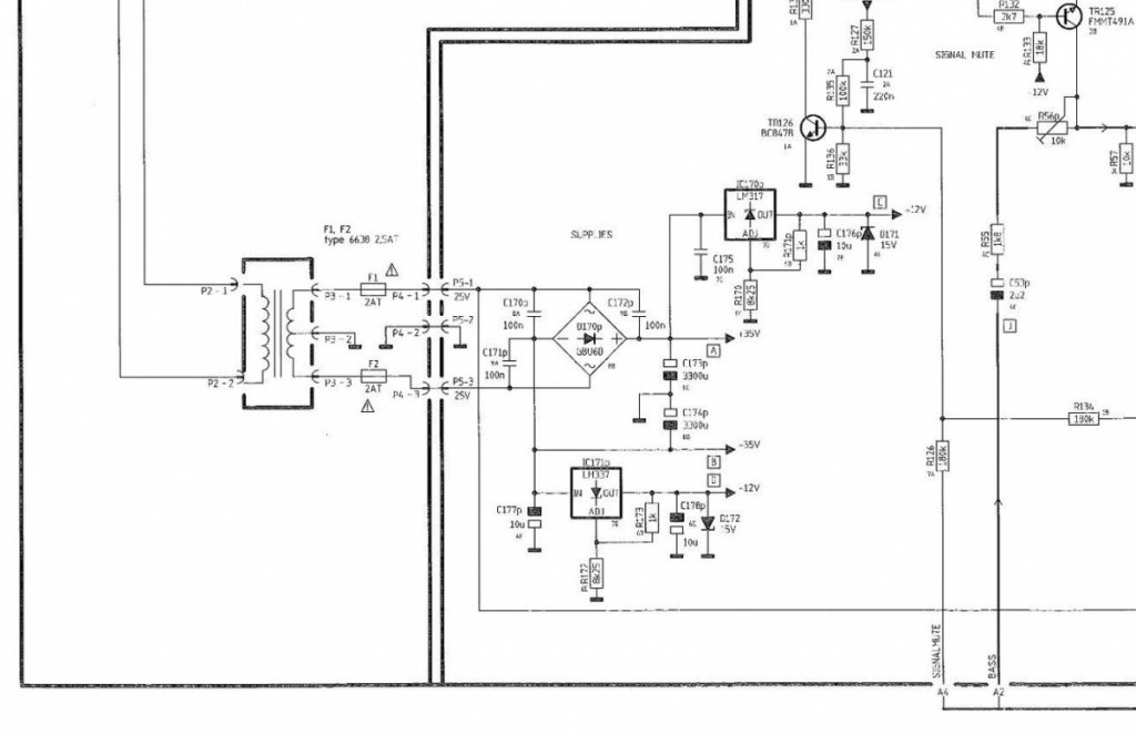

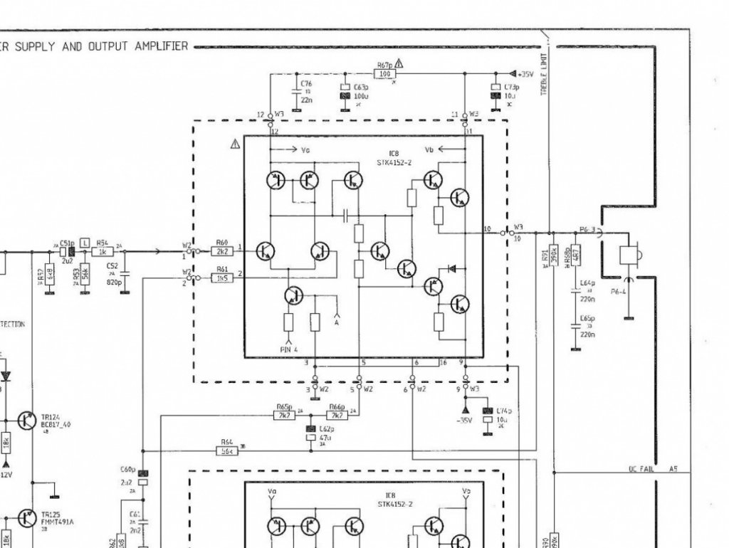

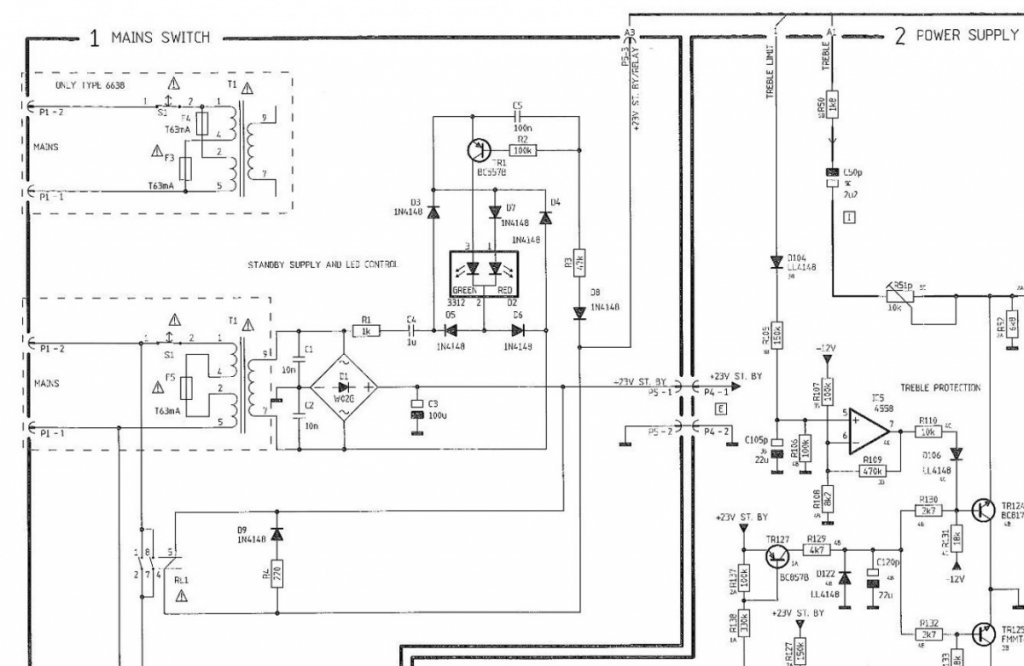

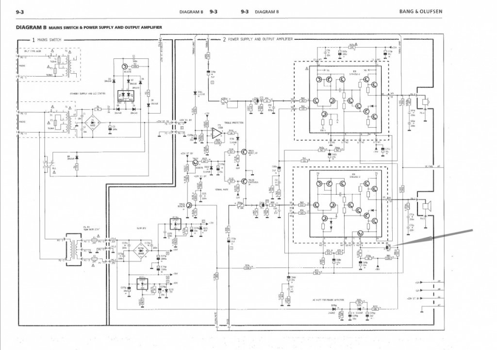

The Speaker is an active Beolab 4000. I uploaded image of the whole schematic but somehow the resolution gets reduced to it being illegible so i uploaded 4 sections. I hope it's not too confusing. Is there any way to upload images here without loosing resolution? Is the image resolution being limited on the posts?

It’s not xo filter nor feedback phase compensation.
The pics are only 640x490 which limits the detail. There’s enough visible to see that it doesnt matter which cap.
EDIT: According to the datasheet for chip amp ic, the cap in question is part of a ripple filter to damp power dissipation when muting circuit is activated. The circuit is similar to but more complex than the mfg sample circuit in the data sheet. Like I said, it’s not a signal filter so the size is not critical, it just prevents oscillation on muting.

The schematic pic was 2653 x 1869 when I selected it to upload. I think pics are automatically reduced by this site when they are uploaded to a post.
