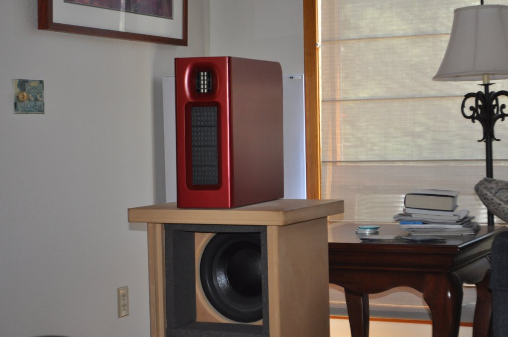

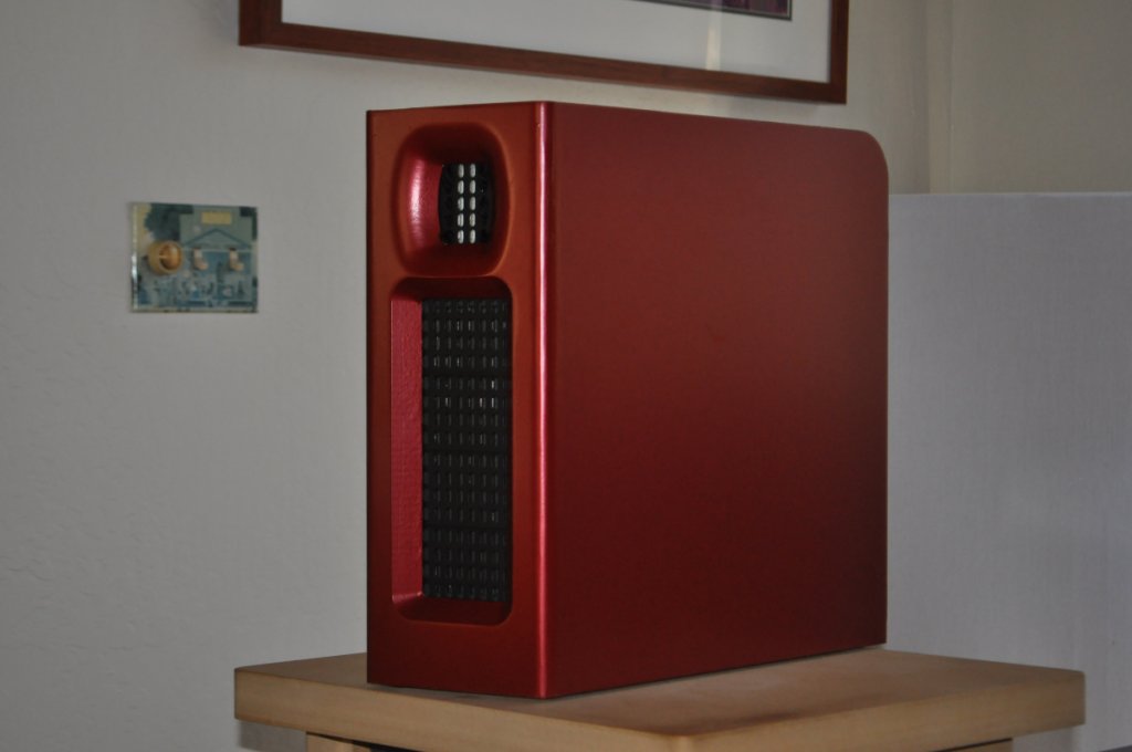

 Not being very patient I tired of waiting for my wife to return from the hardware store. The recessed area took some trial and error. The material stretches quite a bit and with a minimum amount of heat it conforms to the concave area, Then trim. The outside edges are a PITA
I'll spend more time on the wedgies

That looks fantastic!

From the seated position, I agree. Up close is a different story. I'll learn along the way. It comes off real easy.

 I'm going to remove the vinyl down the road. Not real pleased with the stiction in the concaved areas.
