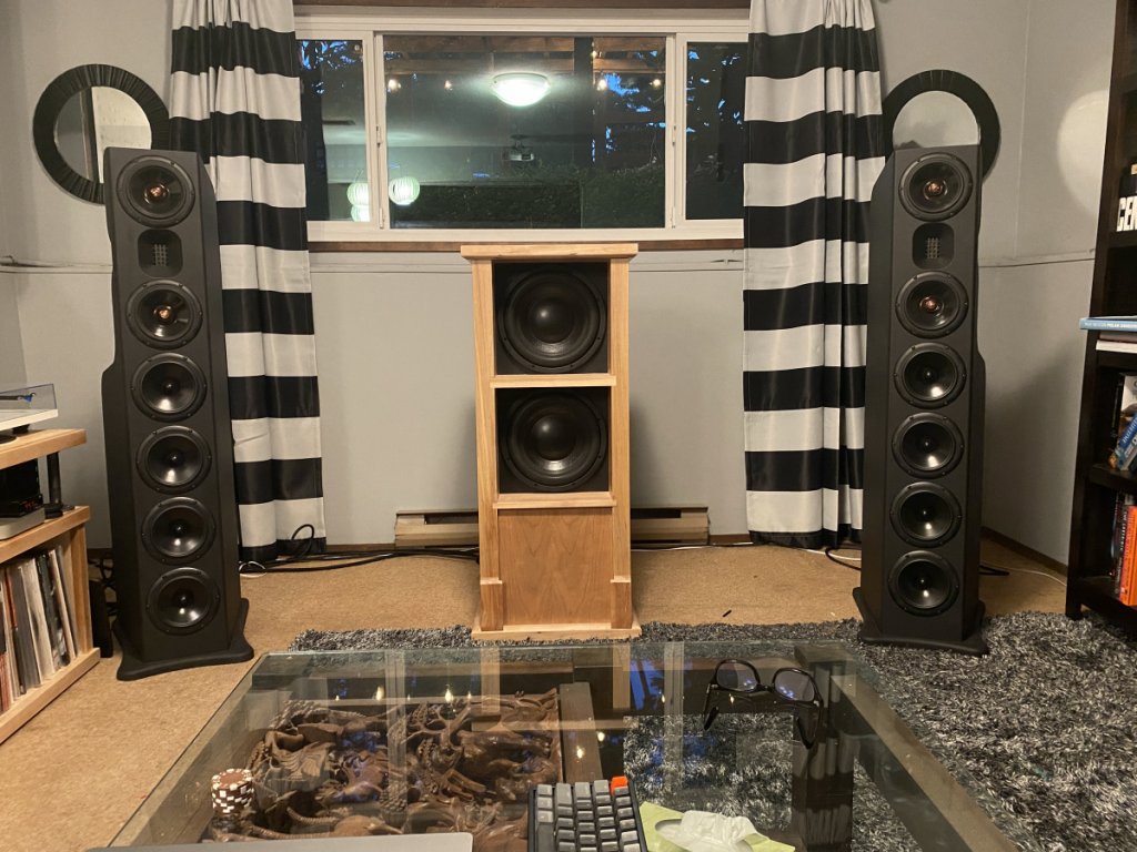

russellberg
  • Posts: 112
Re: NX-otica in a narrow room
« Reply #4 on: 26 Aug 2022, 03:40 am »
Would love to see a pic of a set up if you you or anyone has one, in a room that is about an 11’ wide.
My room is not quite as narrow as yours but perhaps this is helpful.  Mine is 13' wide.  The Oticas are 42" off the back wall and 30" off the side walls.  I just have the one H frame but I also have one of Danny's sealed subs behind the listening position.  I am completely in love with this setup.
