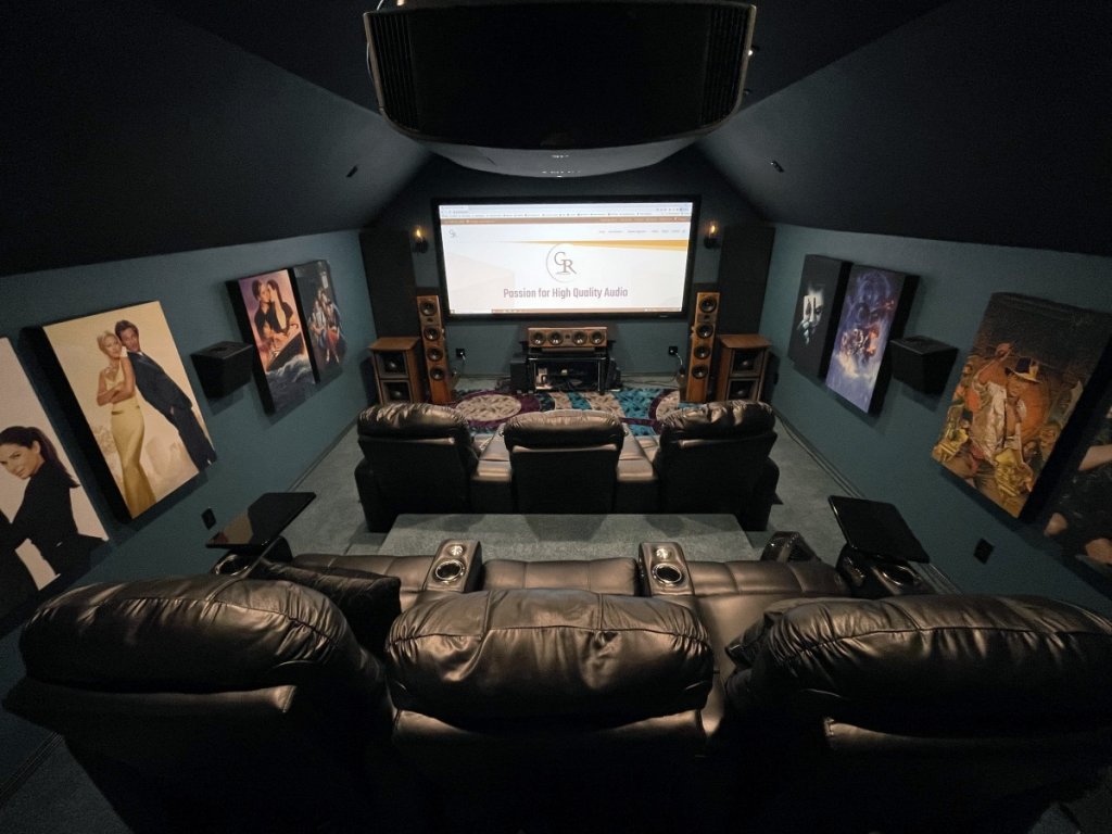

If it were me, I'd do a pair of these for the front 2 speakers:
https://gr-research.com/product/x-statik-kit/
And this for the center channel:
https://gr-research.com/product/x-voce-kit/
These for surrounds:
https://gr-research.com/product/x-on-wall/
This for the sub:
https://gr-research.com/product/sub-series-sealed-servo-with-flatpacks/
This is exactly my setup with exception of the subs.   A pair of the Double Trouble subs at the front and a sealed sub at the back sounds absolutely amazing.    :thumb:
Vince that room looks awesome.  I could only wish to have something like that one day.
Vince in TX
  • Posts: 394
Re: GR Research Home Theater Setup
« Reply #15 on: 26 Jul 2022, 01:30 am »
Thanks.   Yours can certainly sound as good if you stick with GR Research.   :)
