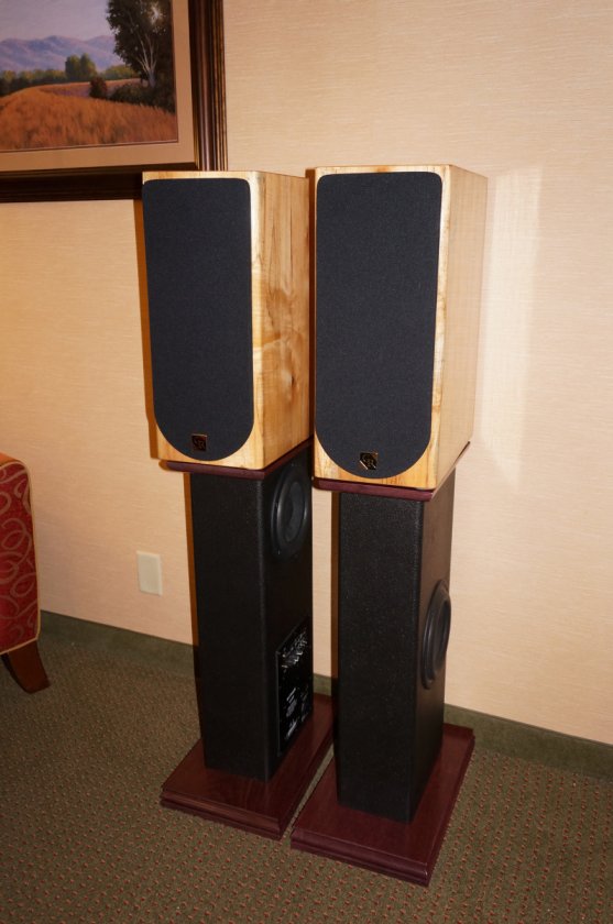

X-CS Encores on a pair of Danny's speaker stands with 8" servo subs
  • Posts: 11644
Re: An LGK 2.0 Review for Those Considering Buying Them
« Reply #11 on: 30 Jun 2022, 04:52 pm »
Mike's right.  You get something like the LGK and it's flat out amazing, and you can't quite believe that there's something significantly better.  But the NX-Studio is a lot better.
I should note I'm basing this on the NX-Studios and LGK 1.0's I heard at Danny's a couple of years ago.
