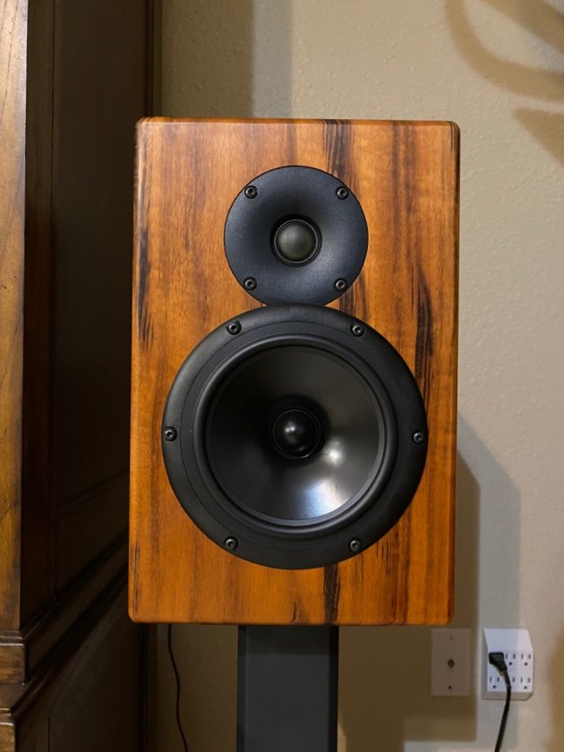

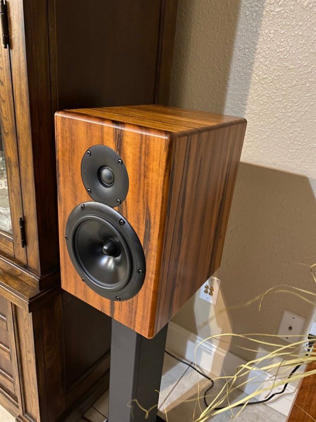

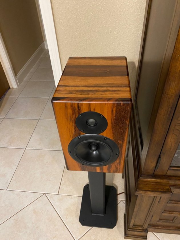

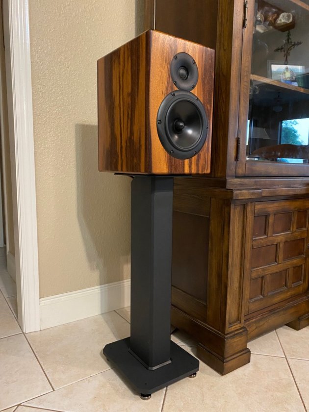

After a long wait my Tigerwood XLS's are finally finished.  :green: They have upgraded crossover parts and a pair of the new tweeters we have all been waiting for.  I would like to thank Danny and his team for demanding a quality tweeter even if it meant deferring sales.  I also appreciate Danny matching components and tweaking the crossover to accommodate the new tweeters.  Quality is the name of the game here.  The speakers are fantastic and are getting some hours put on them.  I hope you guys like the end result.  I know my wife does :thumb:
I apologize up front this is going to be pic heavy.  The pictures make it appear a little orange....they are not that orange looking in real life.
Here is the left speaker:

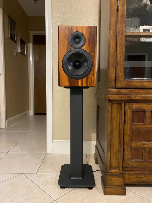

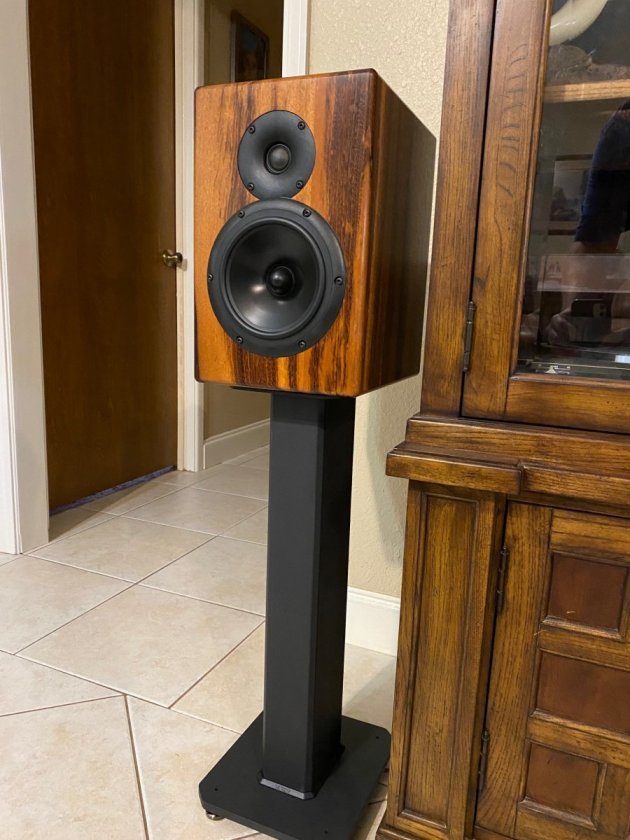

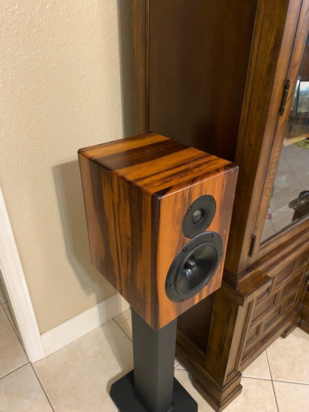

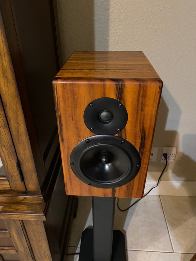

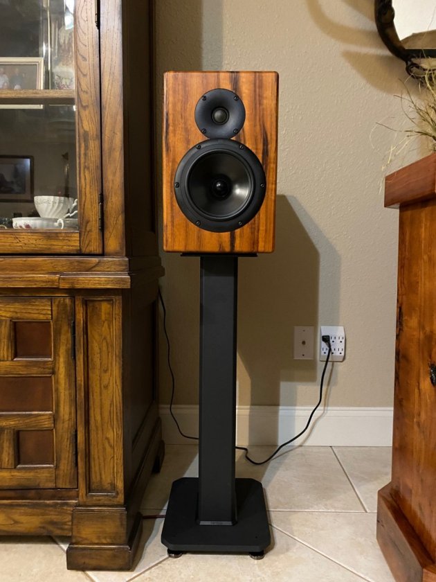

And here is the Right Speaker.  Same thing on this speaker the pictures make it appear more orange than it really is.

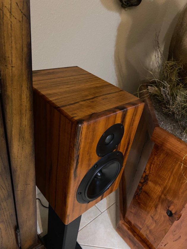

Here is my setup while resawing 4' long x 9" wide mesquite into 3/16" veneer for my speakers. The bandsaw is a 14" Delta from the 1970's. Every slice came out perfect.
The process of making veneer takes a lot more wood than a hobbyist would imagine. Each 3/16" slice takes about 3/8" or more of wood because after cutting a slice off each side, the board has to be trued up so it is flat with parallel sides. Everything has to be perfect to make perfect slices.
The beginning mesquite plank was 5' long x 10" wide x 5" thick and weighed 105 lbs. Most of the plank was turned into sawdust. The joiner is a 16" J.A. Fay from 1905.
