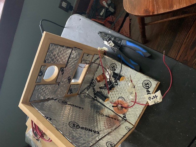

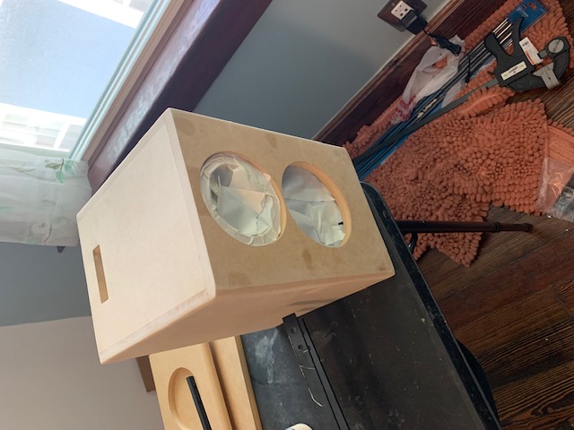

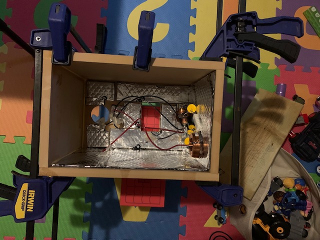

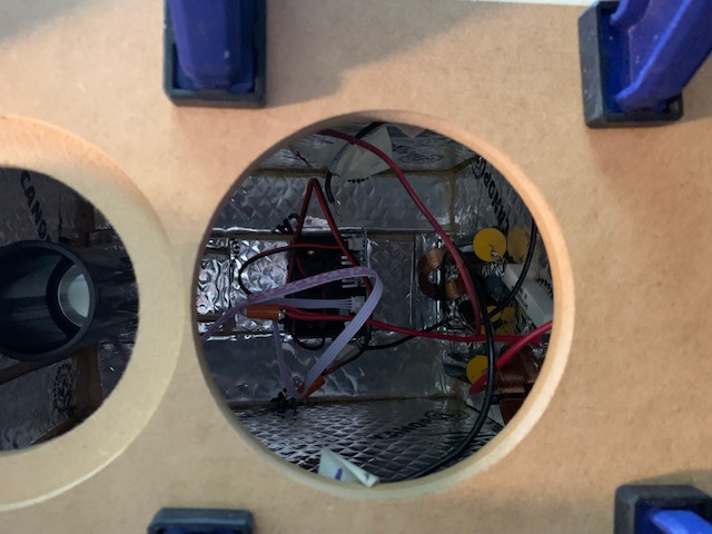

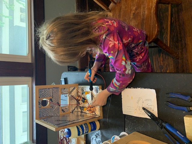

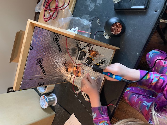

...it again. This time we are building a pair of the 5" two way self-powered C-Sharp kit from Parts Express. Lining the box with Canapus sound deadening material. Crossover is wired and installed and this box will house the amp for both and controls. Tomorrow we will finish the dampening material, assembling the second crossover, and start the second box. We will attach both fronts at the same time after the boxes are finished. Her soldering is getting much better, but I have to consistently remind her that she needs to heat the spot before applying the solder.  :P  Her skill with a tape measure is impressive, she reads out numbers like a pro.  :lol: There will be fewer pics this time, but I will update after any progress.

Lookin good!  :thumb:  You both have done a great job so far. How old is your granddaughter? Sounds like she's a pro!
Canopus is good for reducing the wood vibration but no affect on the air vibration inside the box. When it echos inside the box at wavelengths matching the inside box dimensions you get a resonances which can affect movement of the cone. That's why they add soft material inside the box to prevent the resonance getting too strong. In a ported box you need some air resonance inside the box, but that's tuned to happen only at low freq. The box is small so it will have echo resonances at midrange frequencies which is what you want to avoid. To prevent that you can just fill the box about half full of plain old polyester fluff (polyfill) from walmart or fabric crafts store or sacrifice an old pillow. The woofer and the port need to communicate at low frequency so keep the fluff from blocking their view of each other, but in the bottom and up the back and above the port is fine. It's not critical, fluff won't stop the bass from getting through. You can hold it in place with hot glue, or just stick it in there and forget about it is what I would do. I think it will sound a lot better than empty. She might have fun shopping at the craft store and putting the fluff in.

Thanks for the advice richidoo. I like the tip about not blocking the "view" of the woofer and port. Very good visual description. You are right, a trip to Michael's or someplace similar will be a popular choice.

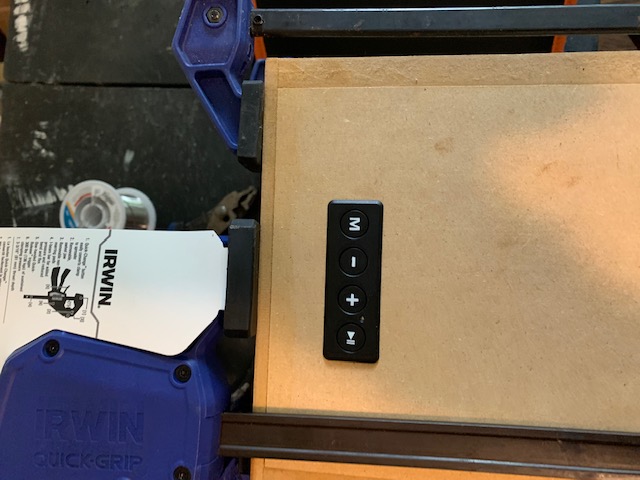

Well I finally got her back on the speaker build. We finished the box that houses the amp and controller. There was no machining of the front baffle for install. They just wanted you to line that sucker up best you could. I did no like that, so I used dowels for both alignment and strength.

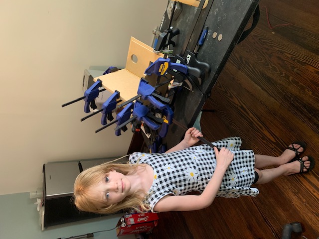

Well I finally got her back on the speakers. We sanded the assembled box and got a start on glueing the second box. Just two pics, but she is in one of them. Hopefully I can keep her on task.  :lol: Who am I trying to kid, she's 8 and has the attention span of a gnat.

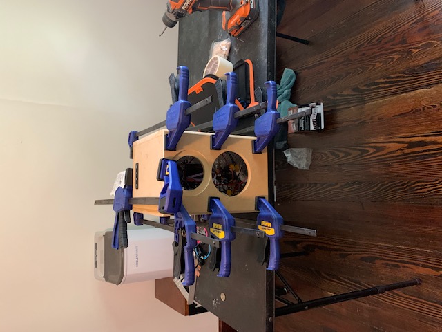

Made a little progress today, woohoo! Lined the 3 sides with dampening material and wired and installed the crossover.
JCarney
Added another pic.
We glued one of the final three pieces in place. We will dowel the baffle like we did the other one after the top is on.
