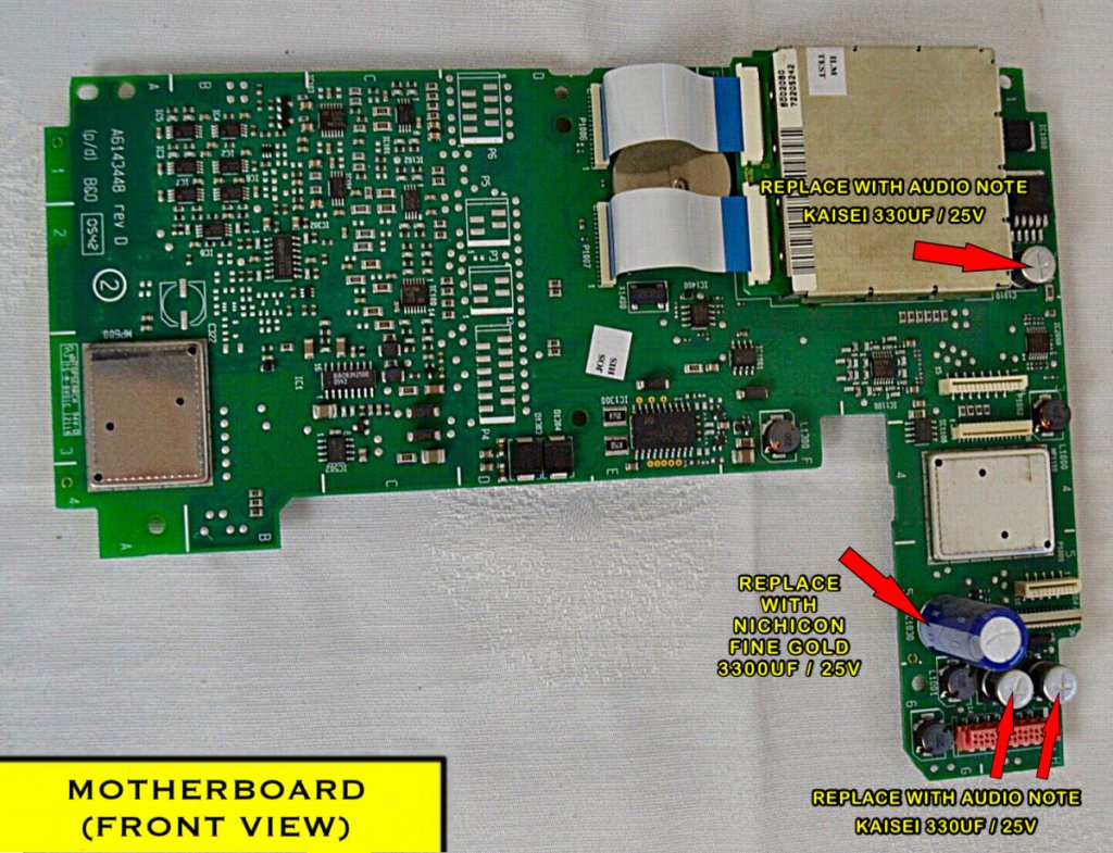

I recently purchased a nice Beosound 4 hifi unit with a faulty glass door mechanism (2007 model year). Everything else works fine. I got it for a great low price. However, the factory paintwork on it is deteriorating (common for the age). The sound quality is pretty extraordinary when partnered with my modded Beolab 1 speakers. Plenty of transparency, with a proper 3D soundstage. So my plan is to redo the paint, but with a better colour scheme.
As for the electrical modifications; there isn’t a lot of things that can be done, due to the extremely cramped cabinet as well as some other issues. Below is a list of the tasks that will be undertaken:-
1) PAINT THE MAIN BODY OF THE CABINET IN MATT SILVER (WITH A MATT PURPLE FASCIA).

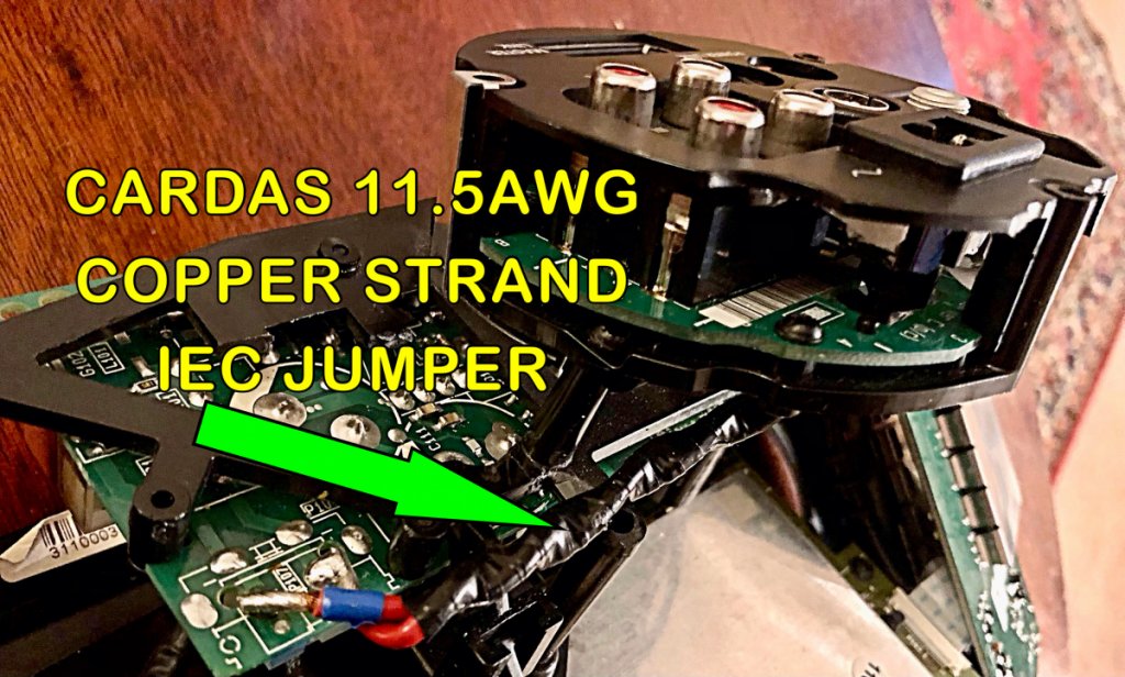

2) INSTALL INTERNAL FIG 8 POWER CORD WITH CARDAS 11.5AWG COPPER LITZ STRAND (66.6666% PURITY).
3) INSTALL JUMPER CABLE BETWEEN POWER SUPPLY BOARD AND MOTHERBOARD WITH 22AWG OCC SILVER PLATE COPPER (66.6666% PURITY).

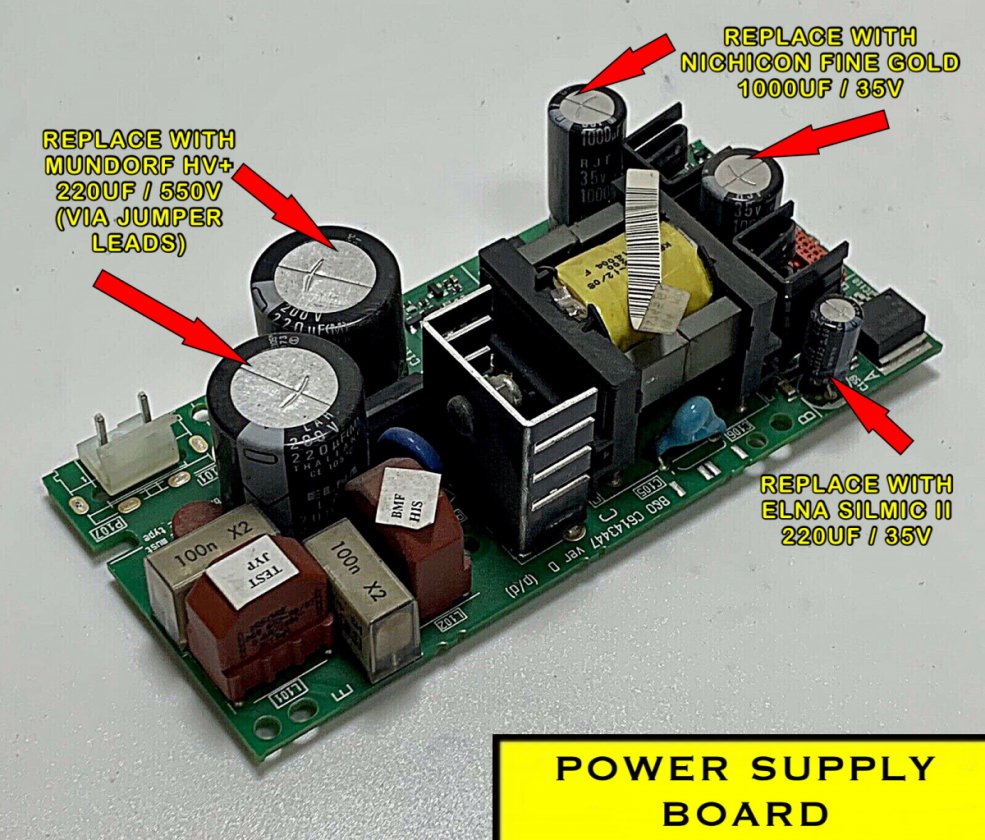

4) SWAP ALL ELECTROLYTIC CAPACITORS FOR THE VERY BEST AVAILABLE; MUNDORF HV+ , AUDIO NOTE KAISEI, NICHICON FINE GOLD, ELNA SILMIC II.

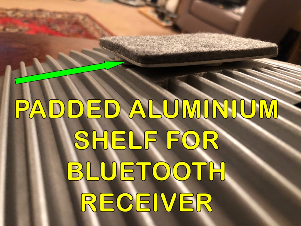

5) ATTACH A STATE OF THE ART ‘IFI ZEN BLUE MK2’ BLUETOOTH MUSIC RECEIVER ONTO THE REAR OF CABINET.

I'm not completely clear on your goal here, but I would have only considered changing the large cap on the Mother Board.  Most, if not all, the others appear to be surface mount.  While that might be a chore for a novice without proper equipment on a multilayer board that is using high temp solder...  They appear to be long life, low ESR parts.  The power supply, I'm ok with that, but would select parts carefully.  I'd also look at the differential mode filter caps (I assume that is what the 0.1uF X2 caps are doing), and any common mode caps...  A schematic would be great.

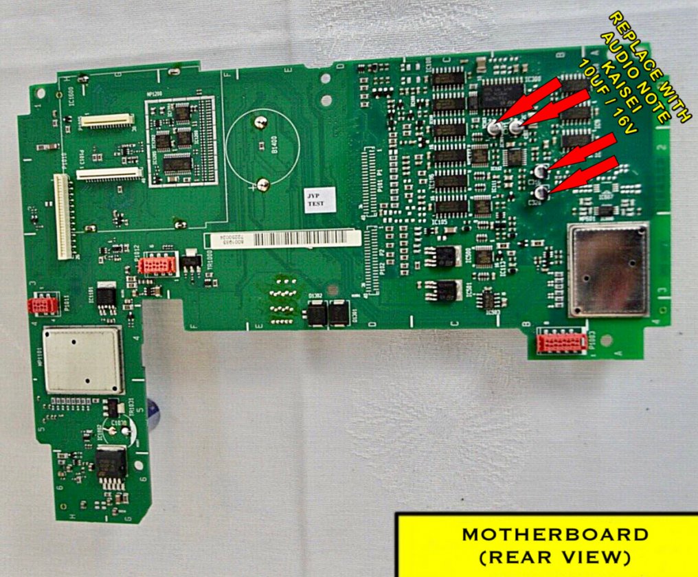

Jeff,
       The sixteen year old Beosound 4 unit is getting on a bit now, so I wanted to replace the existing electrolytic capacitors before they dry out. The faulty glass door also needs attention. So no matter what, it needs to be sent to a Hi-Fi/Computer repair shop. While it’s there I can get them to do the modifications as well (they specialise in replacing surface mount components).
The best quality large cap I could find for the motherboard was Nichicon Fine Gold 3300uf/25v. Unfortunately Audio Note Kaisei, or Elna Silmic II doesn’t make caps in that value.
« Last Edit: 22 Jun 2022, 06:38 pm by OSIB16 »

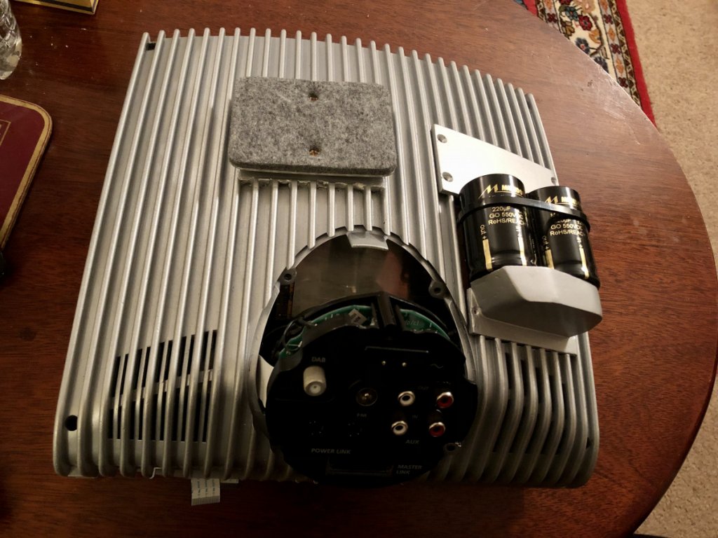

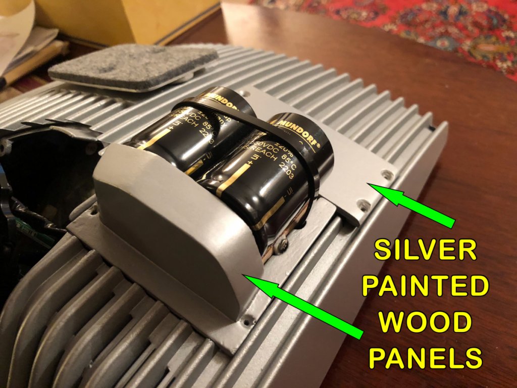

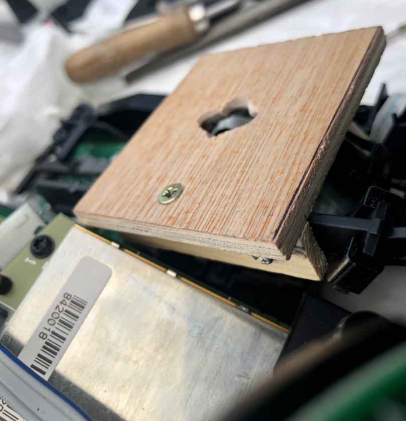

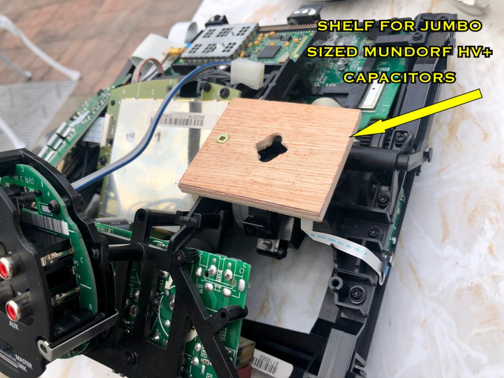

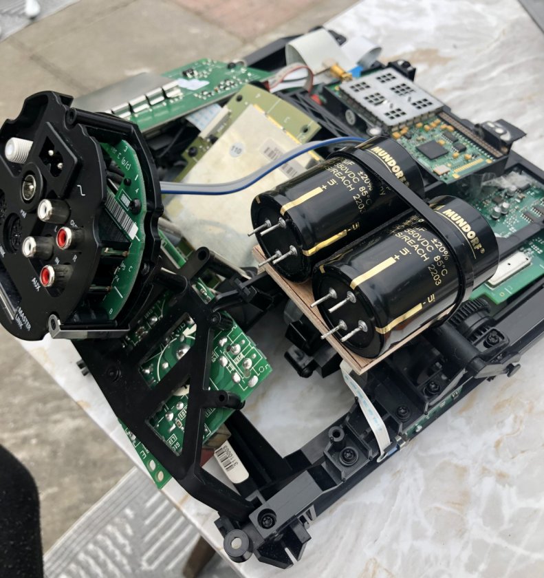

Below are images of the diy shelf I created which allows the giant Mundorf caps to be mounted onto the chassis. Unfortunately there is no room on the power supply PCB to accommodate these monsters.
« Last Edit: 29 Jan 2023, 07:35 pm by OSIB16 »

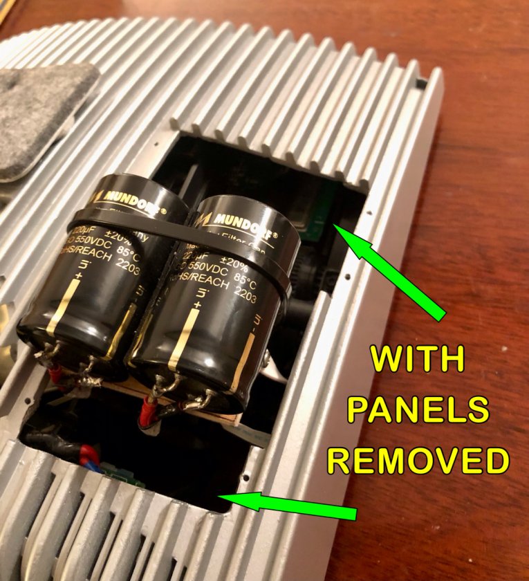

These images show the rear panel that I painted matte silver, complete with easy access panel above and below the big caps…
« Last Edit: 28 Dec 2022, 03:33 am by OSIB16 »

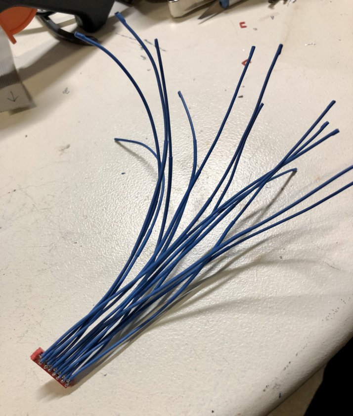

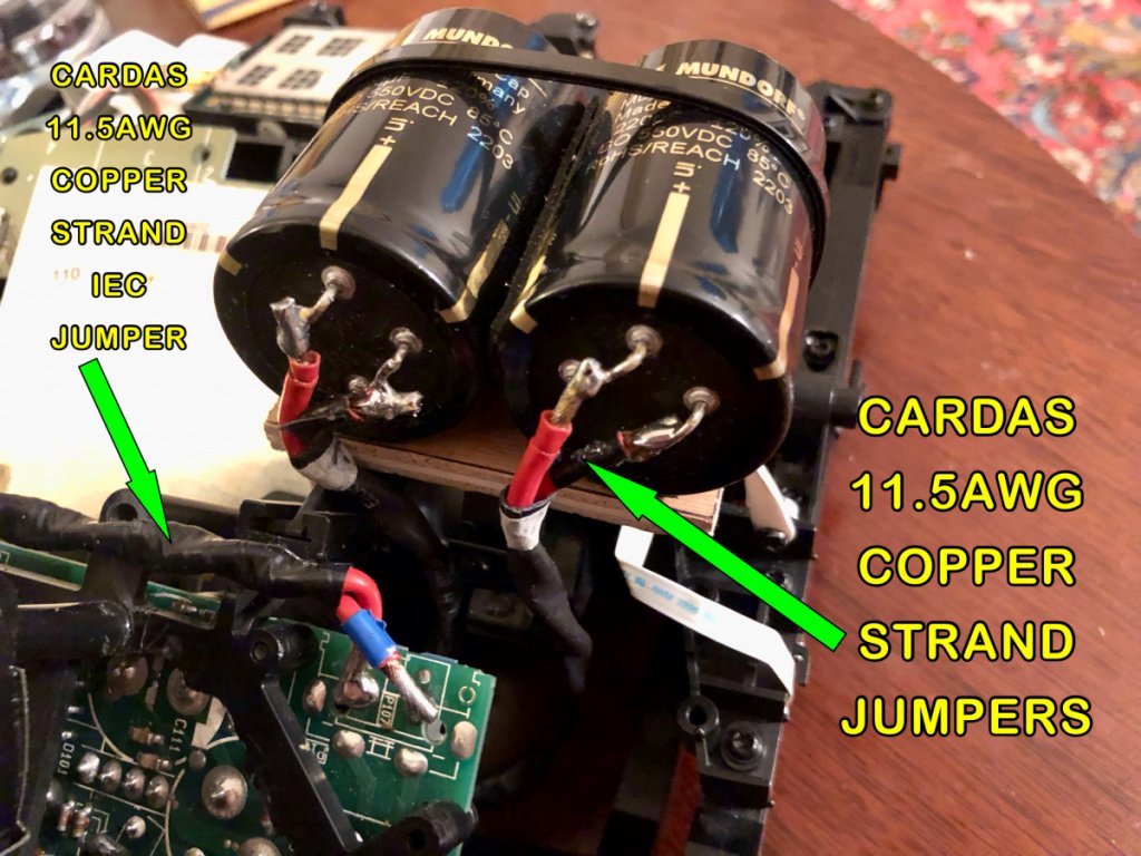

These images show the large gauge jumper wires used…

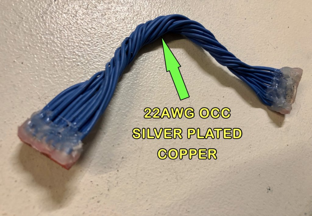

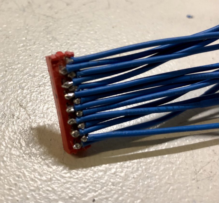

Here is the larger than original gauge umbilical cord that I created with blue heat shrink wrap. It links the power supply board to the motherboard. This is the thickest high purity solid core wire that I could fit into the cramped plugs…
« Last Edit: 29 Jan 2023, 07:39 pm by OSIB16 »
