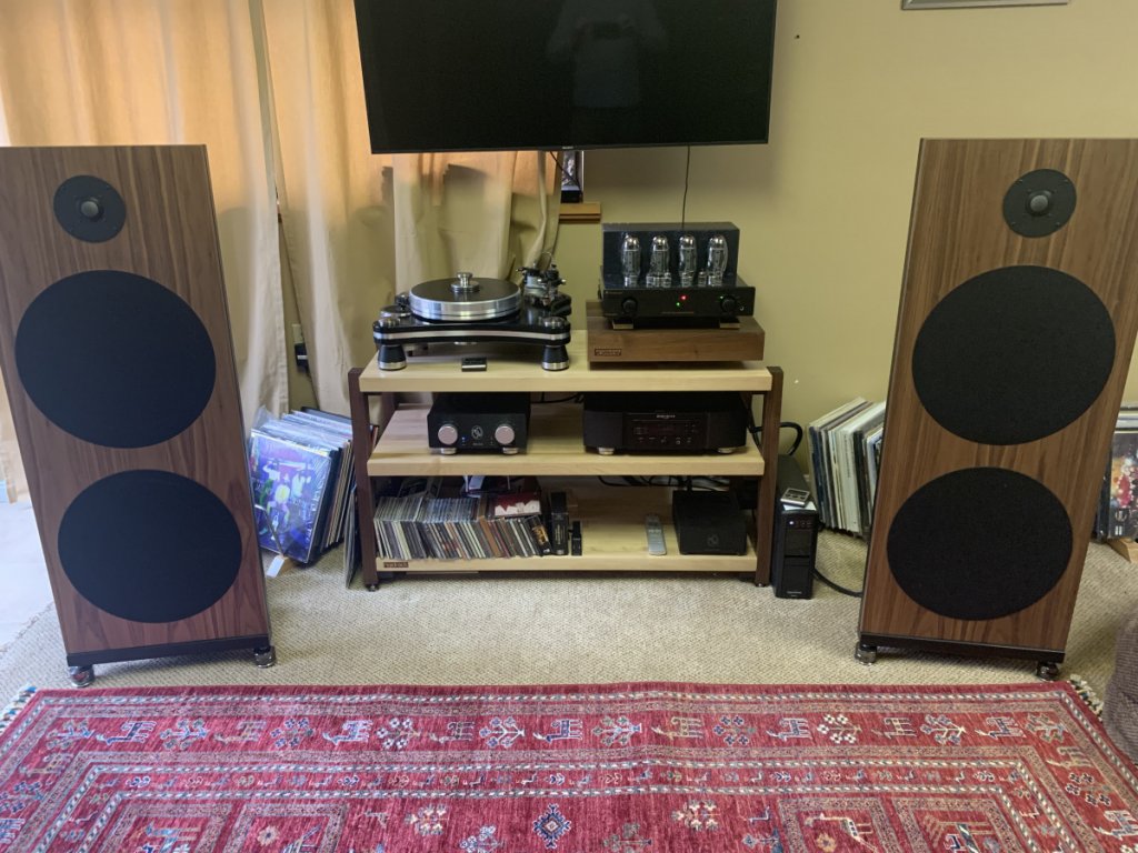

The room is med-large but thinking more about this - one side wall is not a wall and is open which won't work and the other is a "wall" of 3 sliding glass doors (which I will hang curtains in front of but still need access there) so I am kinda stuck w/ the center of the room but - and I know I just need to experiment - the room is fairly deep so I can bring the speakers out quite a ways from that front wall. While I could put the rack in the corner (possibly) I'm not sure how well that will work - maybe.
I'm in VA and trying to manage the work in FL until we arrive 3 weeks from now. I'll probably just have the 2 new outlets in the center of the wall and if he has to come back out to move them that his what we'll do.
The TT and int amp is on the top level of my cabinet and the top of the int amp measures 40". Bummer. But the room is fairly wide so I could probably sell that rack and buy the ones that are per componant on the floor for the TT, Int amp, phonostage and cd player. I'll take a closer look when we're down there.

Thanks All. Right now the top of my top componant goes to almost the top of the midrange on the S M3 (pic looks like it is above but that is the angle of the pic). Because I don't have that many componants I'm going to look at possibly doing amp stands for each of them or look for a stand with less room between two shelves. The int amp and TT will be on top and the cd player and phonostage will be at the bottom since they don't make much heat (only the int amp does which is on top).
Or I might even ditch the top shelf and saw off the uprights for it. Howver that 2nd shelf is exactly 15" off the floor already.
Or just use the shelves as the stands and put Isoacoustics under then. The new floor is ceramic tile, not carpet.
