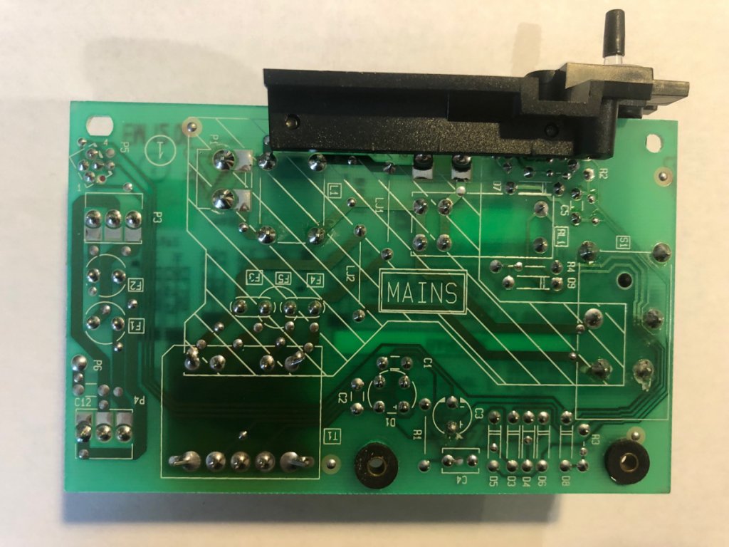

A transformer on the Mains Switch Board in the humming speaker is apparently overheating. After an hour in standby, without audio signal, the outside of the transformer reached 70C. Although at that temp it still did not begin to hum. You can see scorching on the transformer case. The transformer temp in the good speaker only reached 31C in the same amount of time, same conditions and has no scorching.
I installed the Mains Switch Board from the good speaker into the bad speaker. It did not overheat meaning that the other components in the speaker were not causing the overheating.
Apparently the cause of the overheating is isolated to the Mains Switch Board. Could something on that board be causing the transformer to overheat or is the transformer just going bad?
richidoo
Re: Beolab 4000 humming
« Reply #15 on: 6 Jul 2022, 05:02 pm »

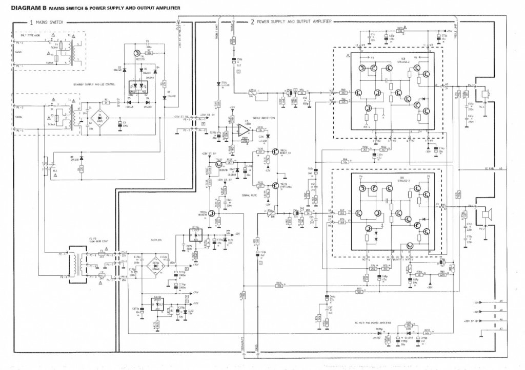

The burning in the transformer probably corresponds to melted insulation on the windings with intermittentl shorts causing the humming and on/offing. It’s not a stable situation, it wont continue to “work ok for an hour”
Generally any repair will replace burnt parts first, esecially a mains transformer, since it is a fire hazard when it blooms into full short. The fuse should pop then.
The rest of the board looks ok.
Its a custom transformer so doubtful its still available, but you never know. If they have enough repair requests they can order more. Worth asking. But they wont send it to you for DIY repair  😁
At least now you can tell them its burnt power transformer, if you can talk to a tech.
Maybe find a used part? They probably all used that transformer and amp in that period and product series.

Since I have isolated the problem to this board, is it likely that something else on this board could have caused the transformer to overheat or was it just a failure within the transformer itself? I know it's a tough question but what is your gut feeling?
I did take your advice, rolled the dice and took the easiest way out. I just ordered a used board on online. The picture doesn't show any scorching. I will monitor the temp and hope there are no other problems with the used board. Hopefully I will be humming instead of the speaker.

Tranny actually feeds two power supplies. One small one on the tranny board and another on the Power Supply and Amplifier board. If a  rectifier diode is failed it might cause overheating tranny. I'm not qualified to surmise much beyond that. Worth checking the diodes. You can lookup how to do it on utoob, but I think you have to lift one end, but I could be wrong, I only did it once. You could just remove the diodes with the intention of upgrading them anyway then test them when removed. Diodes are pennies. Well maybe not nowadays haha
Good job finding a replacement board. I hope it solves the problem!

Am I correct in thinking the Power Supply and Amplifier board is not causing the overheating? When I installed only the Mains board from the good speaker into the humming speaker the transformer temp on it did not go above 31C and there was no hum.
Is it likely that some very subtle problem on the Power Supply and Amplifier board could be degrading the transformer so slowly that it would not be evident until after a much longer time? Obviously I won't find out until it is too late.
richidoo
« Reply #19 on: 7 Jul 2022, 05:23 pm »
Yes
No
