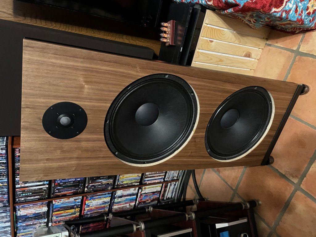

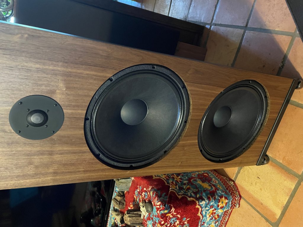

I too like the naked look with grills removed. Depending on the finish of your speakers you may be disappointed. My M3's are Walnut veneered and when the grills are removed it exposes the unfinished MDF (see picture). I stained that portion on mine so your eye is not drawn to it but it is still unsightly. I have been considering making some sort of beauty ring but have not come up with anything yet.

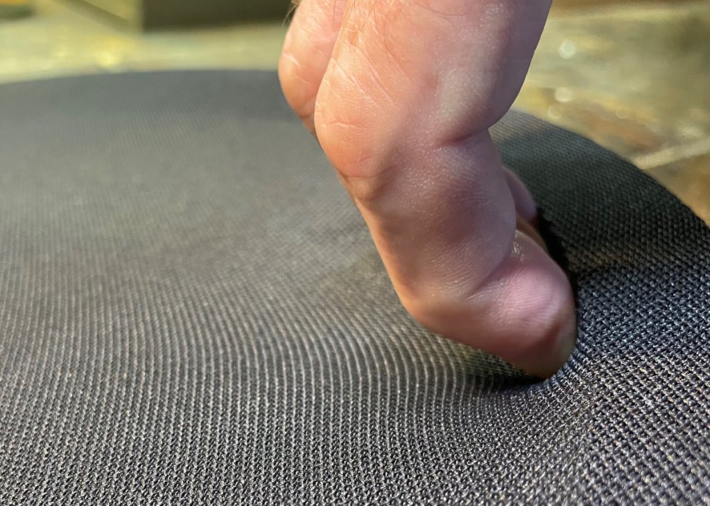

To remove the grills press your fingers into the inner side of the outer ring  (see pic) and pull. The fabric will not get stretched and will spring back nicely.

EI Tio thank you so much. Man mine don't want to budge. Maybe I'll try a different spot on the grills.

Same issue. I got one out but the other three are in tight.

Well you really have to just get in and back enough to get your fingertips behind the grill ring. Can be easier said than done :) I wanted to add that Spatial did not install the grills halfheartedly. Very tight quality fit.

I used my fingertips from both hands on the outside of the grill.  And yeah they are on there tight.  So gotta use a fair bit of finger strength to get them off.

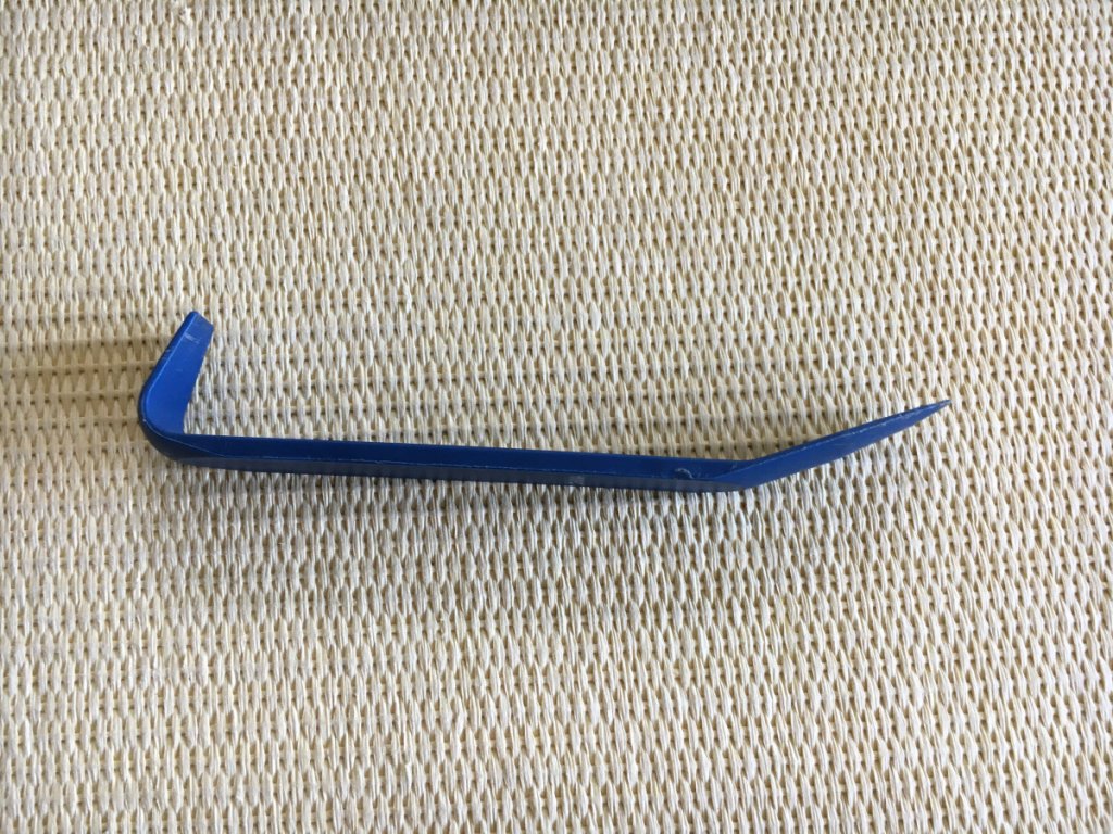

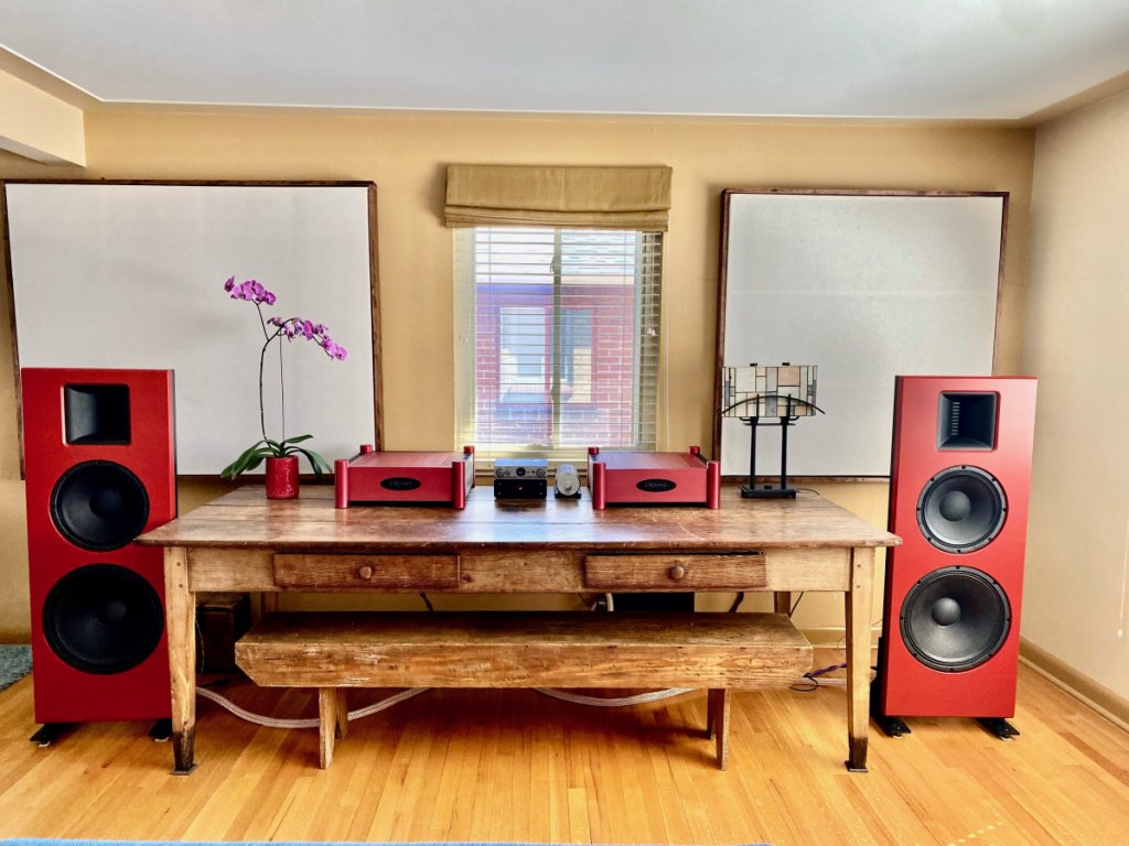

Okay sport fans, after blood, sweat and tears I just got my Red X5's grills removed. Blood coming from one finger nail separated from a finger, sweat coming from the strain on the fingers, and tears of joy after finally getting all 4 grills removed with a greater sound improvement to my ears.
Attached is a picture of a helpful tool which is a car interior removal tool.  Carefully work around 1/2 of speaker in minute increments and pulling on the outer edge and it will eventually come out. Be careful not to push the tool too far in the groove to avoid chipping the paint. A little leverage goes a long way.
