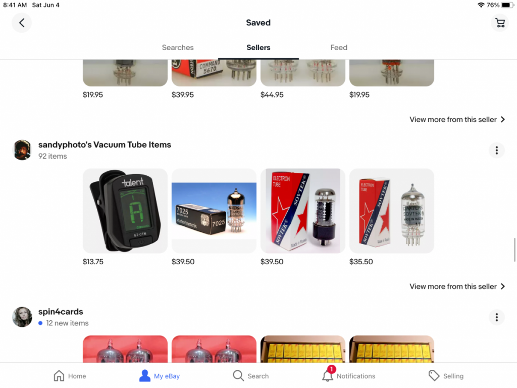

I purchased my tube dampers from seller sandysphotos on EBay.  They work well for their intended purpose.  I read an article about a year back that said tubes are not meant to have dampers so I no longer use them.  But as always, use what you like.
FYI - I have never used these on power tubes bit I did put them on 300B’s and I thought it degraded the sound.
