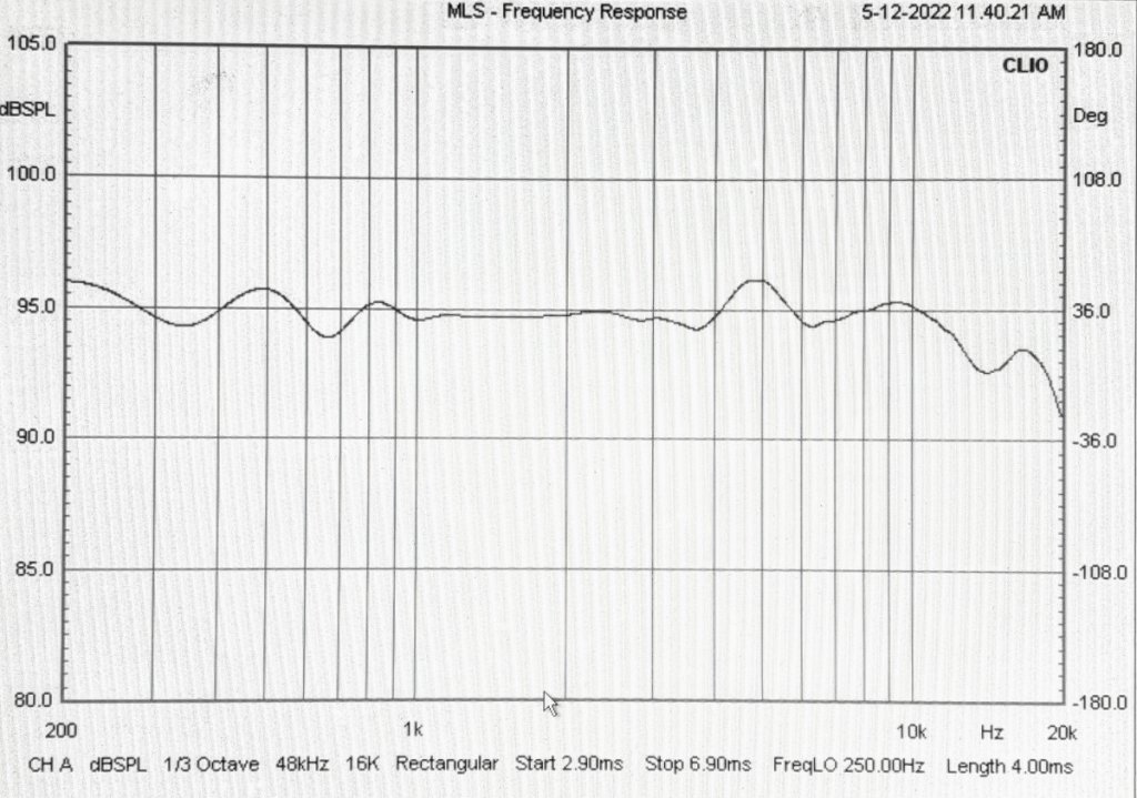

Anytime someone claims a monitor with a 6.5" woofer in a 15 x 8 x 13 inch box delivers over 90dB sensitivity I just assume the measurement was made on a good day....running down hill.....with a tail wind....and a couple of shots of nitro.
The Mk II's spec sheet reads "SENSITIVITY* 94.5dB @ 2.83V / 1m*" the twice repeated asterisk being "*SPL at 1M, half-space anechoic with 2.83V input, in-room sensitivity". I think that half-space note is the downhill help. That's the equivalent of flush mounting the speaker into your wall so all output is constrained to the 180 degree forward arc.

Klipsch says their large RF7 III towers are 100dB sensitive, but that like one peak in the 5KHz range of the tweeter.
It's average is closer to 95-97db.

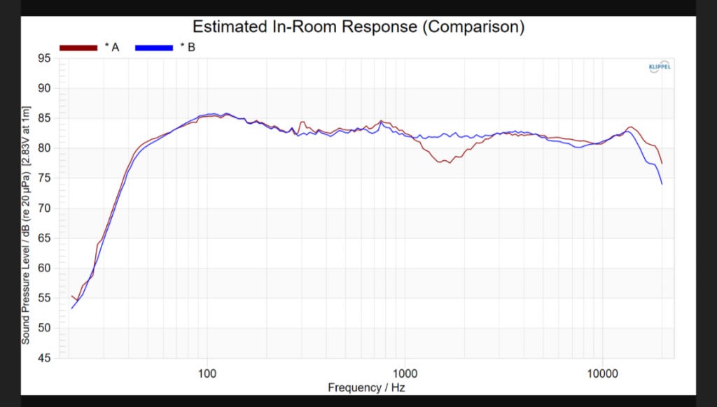

When a woofer is placed into a smaller airspace than it requires, you get a bump in midbass output followed by an early roll off. The larger that difference, the more dramatic it is.
The XLS bookshelf actually uses the airspace required for a sealed cabinet. Porting it boosts the mid/upper bass 1-2dB but causes the -3db point to be 55Hz while the X-SLS is more liniar in the midbass, and rolls off around 45Hz instead.
The difference in the 600M v2 is about an inch in both height and depth, so if there are differences it may be minor but the differences created by the longer voice coil and copper shorting rings are still unaccounted for.
The crossover is likely very similar but may be using some slightly different values to better allow the drivers to play together.
However, it's also not known if the larger waveguide for the tweeter is also to better account for the difference in the voice coil depth of the woofer, allowing for proper phase coherence without having to make any major changes to the crossover.
This Klippel "estimated in-room response" from Erins Audio Corner, looks really similar to our measurements of the RP600M (thought not officially listed as such) and includes both a "new and old" version of a speaker.
Assuming this is the 600m vs the V2, they do appear to be nearly identical at stock. Except for the lack of a dip at the crossover point and a slightly early roll off at the very top end.
It might be possible that swapping the woofer out may benefit the speaker, but it may also not make much of a worthwhile difference if any. It's hard to really say one way or another without comparing both woofers side by side.
