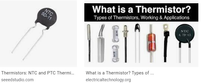

I built a guy a pair of speakers many years ago using Focal T120K tweeters.  He kept frying the tweeters so I used thermistors to protect the tweeters. Worked like a charm; he never blew another tweeter. Not sure what he was doing to fry the tweeters but I never had anyone else blow those tweeters before or after him.

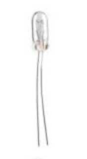

You can use small lamps instead. They don't have a negative effect that is noticeable. If too much juice is sent to the tweeter they'll light up instead of burning the tweeter.
I can't see any of it working for woofers.
HT1278
  • Posts: 152
Re: Adding fuse to protect speakers
« Reply #7 on: 1 May 2022, 04:13 am »
Which of these types did you use?  About the fuses, I spoke to my Dad and he said he had some Bose speakers that my brother would play way too loud so he put fuses in line.
I was playing some speakers today, and my friend thought they heard clipping then I considered perhaps I should add some protection.  The speaker only has one driver though.
For the thermistors, or bulb which of them would be used, and where should they go?    I am assuming they would go on the crossover?
Just don't want to open the speakers up again.

I used the round, flat, disc shaped one and wired it inline with the positive terminal of the tweeter. This was done after the crossover and up close to the tweeter.

Using a thermister on a full range driver will cause more issues that it would solve. It can help to protect a tweeter, but the bass & mids frequencies will immediately raise it's resistance.
Agreed, I didn’t realize this was a full range driver. I would think you’d be hard pressed to damage this driver when using it for its intended purpose.
