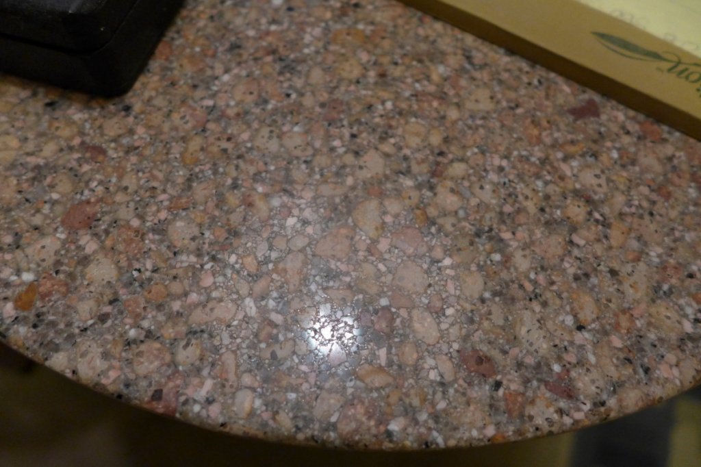

Reading your post and looking at photo makes me thing this is some kind of overlay that's offered as countertop resurfacing material. I used to do business with a company called Granite Transformations that offered similar. About 3/8" thick, and had origins in the commercial flooring world. Here's a table I had them cut.
