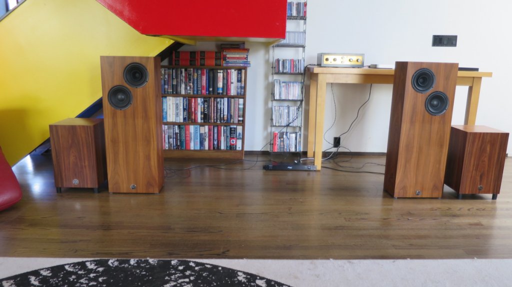

i've decided to part with my beloved omega super-alnico high-output XRS's.  since you're here in louis's circle you already know how wonderful these speakers are.  my reason for selling is simple:  i'd planned to use my omegas as a second set of speakers in my principal listening room, driving them with my ampzilla monoblock amplifiers, but as described above in this thread, these components just don't play well together.
the XRS's are in perfect condition, not a scratch or dent anywhere.  along with them i'm selling a pair of deep-hemp 10" subs.  all speakers, as shown, in rosewood.
i have the original boxes for all four speakers, but since i picked them up directly from louis's workshop in connecticut, i don't have shipping boxes, so either you'll have to arrange shipping yourself, or you can come pick them up at my place in westchester, new york.  in that case, you can get a chance to hear them with a variety of amplifiers (just not with the 300w/ch ampzillas!)
the original cost of all four speakers was 7K, and i'll be asking 6000, which really is a great deal given how backed up louis is these days.  i'll entertain reasonable offers.
