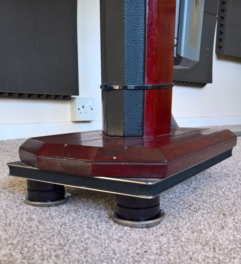

I have used granite, concrete and wood, they all sound different and work to a certain degree.
I have now settled on using Symposium Svelte Shelf + Symposium Roller Roller blocks under my speakers. Counter intuitive even though it allows movement, I get sharper defined notes and bass is deeper.
What you see in the image below is IsoAcoustics carpet shoes / Symposium Roller Roller blocks / Symposium Svelte Shelf and the speakers sitting on top of that stack.
