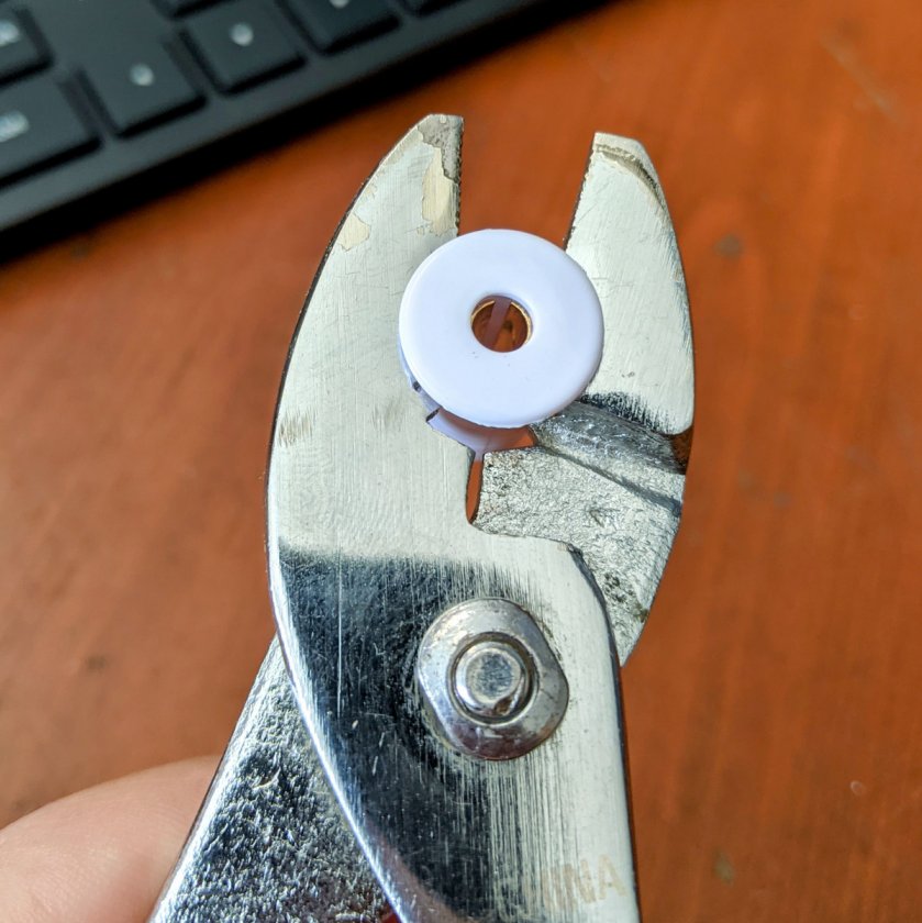

I completed my Klipsch RP-8000F and RP-504C crossover kit upgrades recently. I think they sound great! Thanks Danny and Hobbs for your help!
One area of concern for me. After installing the Electra Cable Tube Connectors, with a few of them, the connections seem too loose when inserting, no effort at all. I just couldn't imagine a connection this loose having a good solid contact. In the spare of the moment, maybe without thinking about a solid solution, I took and (for lack of a better term) squished the male end a little so it feels tight now. But, after doing this, in my mind, maybe the actual contact area is less now?
What do I do? Leave it like this? Get new male ends? (If available?) Use some high quality banana connectors?
Looking for advise please? I can't imagine I'm the only one that has loose Tube Connectors?

We're supposed to tighten the female ends before we send them out, but it seems some are getting missed. I'll let our guys know to make sure they'rr snug before they leave.
But the best way to tighten them is to remove the male end then use pliars to squeeze down on the female ends, going around in a circle to make sure the shape allows for good contact all the way around, without damaging or deforming anything. Then if they still feel loose, adjust the depth & how hard you're squeezing until it feels snug.
Adjusting the male end less than ideal. As it cant really be undone
We do sell the male ends for $3 each if you would prefer to star over.

Thanks Hobbs, yes, I would like to start over and do it the proper way. I didn't think of tightening the female end because of the coating. I like to learn something every day!
I would like to order 6 please, what is the procedure?

I realized my tube connectors needed tightened after I had hot glued them into my Klipsch  :duh:
I appreciated Hobbs quick reply. Got them removed and squeezed down. They are amazing. I’ll be adding a set to my amps soon as well.
