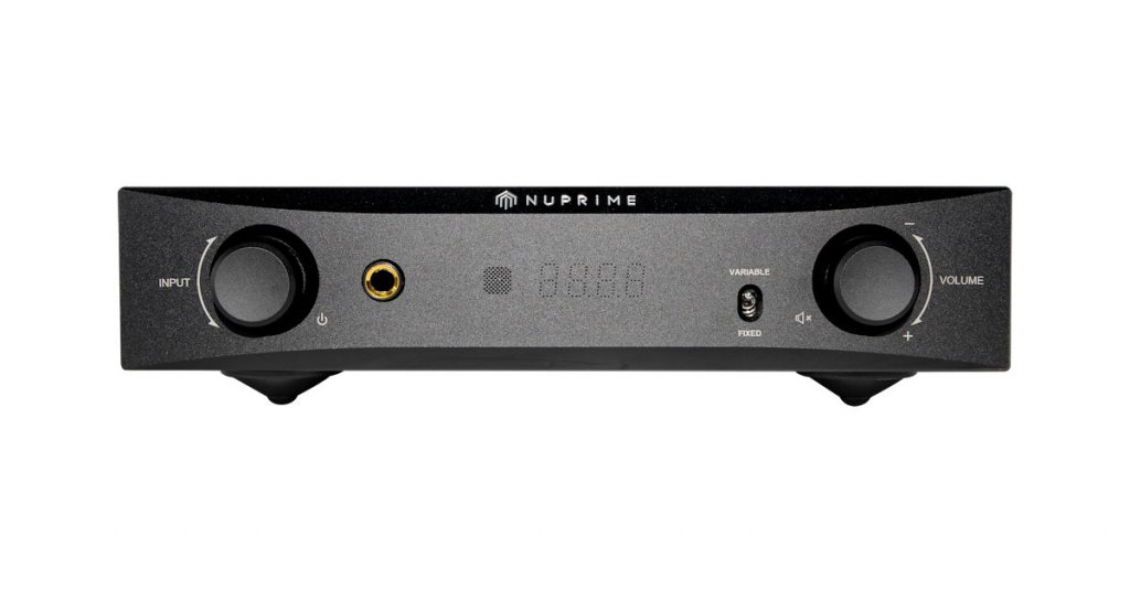

PRA-9X has three outputs if you count the headphone amp in addition to XLR and RCA.
Did you miss the headphone amp output on the front panel?

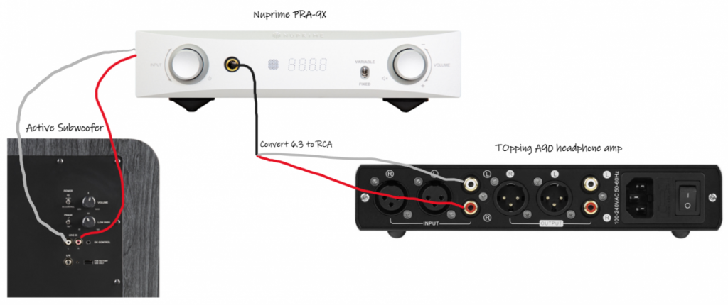

Let me know if I am understanding: I require a cable that convert the 6.3mm headphones out to RCA stereo, then I can connect it to  headphone amp, and set pre to fixed vol.  Is this correct?  Sounds easy!

I see, you want to use another headphone amp. But if your headphone amp has volume control, then you can just connect PRA-9X RCA output to the headphone amp, and use the XLR output for power amp.

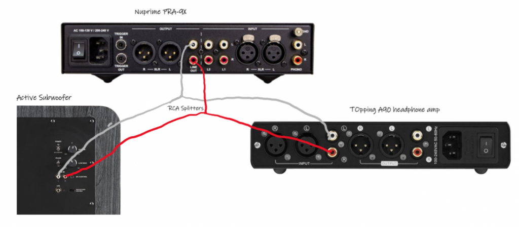

I understood that an option is to connect from headphone output (in PRA-9X) to my headphone amp (Topping A90) input stereo RCA (I'll convert from 6.3mm headphone to RCA stereo), then I'd set PRA-9X to fixed vol. to use the headphone amp vol. control.  Is there any drawback on doing this?

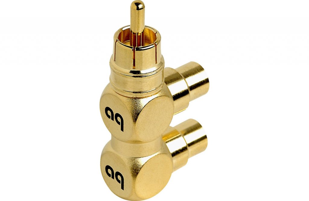

Other idea is to connect headphone amp and subwoofer simultaneously, from RCA outputs (in PRA-9X) using two Y-RCA splitters (one for left, other for right), so from left RCA I'd connect to left input subwoofer and to left input in the headphone amp (the same for right channel).  I don't like this idea because it will be sending an audio signal to the subwoofer always, and at some moments I wan to use only my headphones.

« Reply #8 on: 13 Sep 2022, 10:50 pm »
This is what I'm thinking, I'd like to know if any (or both) of these options are possible and if there are any drawbacks:
Notes::
 - Stereo amplifier will be connected to the XLR outputs (not shown in the drawings).
 - Any time I'd use the headphone amp, the volume in PRA-9X will be set to fixed.
Option one for connecting two devices at the same time using RCA only:
Option two for connecting two devices at the same time, using RCA and headphone output:
