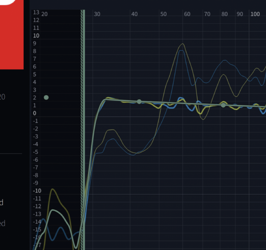

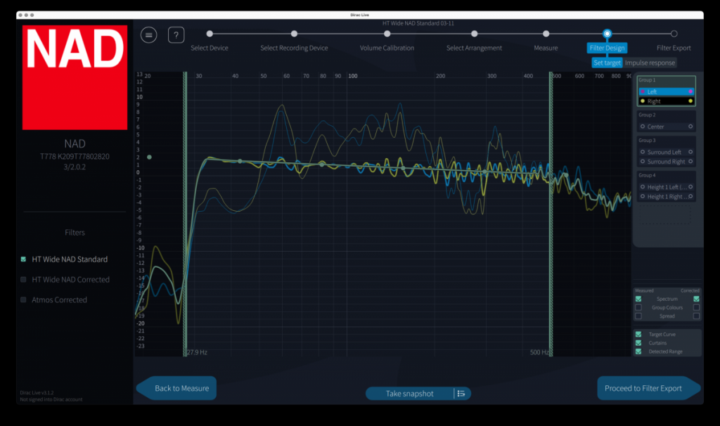

Then there are those measurements, Dirac shows nothing really happening until almost 60Hz. I’ll attached a pic. If I move my Dirac curtains to 50Hz the problem pretty much goes away. Obviously I need to work on positioning in my room.
Still this whole thing seems odd to me. I’m new to the Dirac stuff and frequency responses. I have REW downloaded and may work on some positioning this weekend but I don’t see why that would keep my driving from bottoming out.

The image is not large enough for me to see what is going on and you do not have a link to your gallery where it is posted. I am not a pre/pro expert however
1- If you do not have a sub and the main speakers are set to full range or large they will play the full signal being fed
2- The graph looks as if Dirac may be applying room correction below 50hz.
3- The combination of using EQ boast below 50hz + sending a full range signal to a speaker with a movie soundtrack that can easily have 10hz bass frequencies will certainly cause the woofer (its not a subwoofer) to reach it's xmax. That is what you are hearing and this is not specific to a Spatial speaker but any speaker where you artificially boast the low end and then feed it a signal well beyond what that speaker can produce.
If you want to continue to use EQ on the bottom end for music you can try setting the M3 to Small in the processor and cut them off at 40hz 12-24db per octave. That should create a natural roll off and give you plenty for music but not cause driver excursion issues with movies.
Hope that helps.

I'm attaching a closeup of the curve here. Only the items to the right of the vertical green curtain is what Dirac is adjusting. To my eyes, it's only concerned with about 32Hz and above. So I would think no sub frequencies would be going to the mains. The amp knows I don't have a sub so it should not send sub frequencies to a full range speaker, at least that's my understanding. I'll need to dig into it more.
Keep in mind this is a Dirac measurement using a wide range of locations around my listening area.
This just occurred to me, say the speaker is hitting 32Hz somewhere else in the room but only measures close to 50Hz at my listening position. Is Dirac pushing it to 32Hz at my listening position causing the speaker to actually be pushed beyond their limits? This is totally an uneducated guess.

I'd also like to ask, looking at the closeup of my response. The thin blue and yellow lines are the M3s actual measurements. Is that small hump around 32Hz actually anything or are we not seeing any real low end till around 50hz? I'm still trying to understand these graphs.

Re: your graphs, it looks to me like there's before and after.  The really lumpy lines are before and the very smooth lines are after.  You can see in the before line that you're not getting much bass below 50hz in your room with those speakers.  So yes, IMO you need some subs, even for music.  If it were me, I'd get a pair of OB subs for music, and a sealed sub or 2 for the HT LFE channel.

Thanks! The thin lines are the measurements and the thick ones the Dirac corrected. The solid green is the target curve.

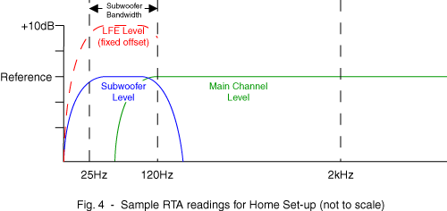

Generally, in a setup without a sub, bass below the center and surround speakers' highpass-filter frequency, along with the LFE channel, is fed to the front speakers.
Music systems with and without a sub are set up for a flat frequency response. Home theater is a different animal.
In home theater, the LFE channel fixed offset is +10 dB above the main listening level, this gives soundtracks the necessary oomph for all those special effects we love.
You will have to contact NAD tech support to find out what happens to the LFE level when there is no sub and front speakers are set to large. Is the LFE level attenuated or is that fixed +10 dB sent to your main speakers causing them to bottom out? You won't always be around to gain ride the volume when the girls are watching.
