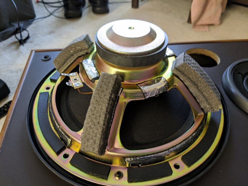

« Reply #9 on: 6 Apr 2022, 10:26 pm »
Hi Hoobs. Read somewhere that Butyl are bad to the rubbers on the woofer cone. Is this correct?
Bought some and change to a “dynamite” look a like instead, to be sure. Overkill?
Dynamat is a butyl rubber based damper and i usually use look-alike products without any issue. It may cause issues if directly touching some rubbers, but if you just stick it onto the arms of fhe frame/basket and keep it away from the rubber it'll dampen out any resonances without damaging the surrounds.
Here's some on an old Technics woofer.
I put some foam dampener on this speaker as well but it was only to soften direct reflections rather than dampen the ringing. You can see the butyl stuff around the woofer and under the foam strips.
