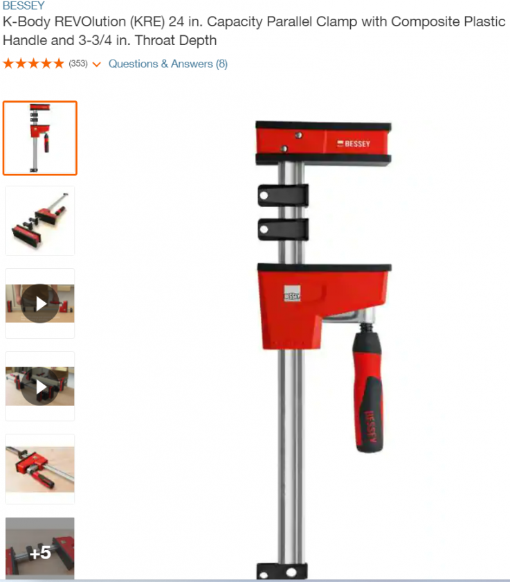

Instead of all of those clamps, these actual cabinet clamps look a lot better!  Just more expensive.  The Bessey UniKlamp is less expensive than the Bess
ey K-Body Clamps.
