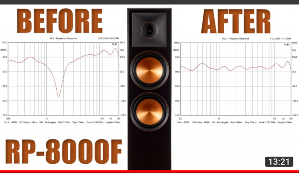

I just finished the upgrade on my Klipsch RP-8000f right speaker and noticed it is about 7.0 decibels less efficient than the original. Anybody else notice this? The cymbals that were missing on the original build are now back. The Cymbals on the Jazz at the Pawnshop Lighthouse track I can hear again. Seems like before the upgrade the mid-range was washing them out. Anyway just seeing if anybody else is noticing a drop in efficiency.

If you look at the before/after response the RP 8000F does lose about 3-5dB of effeciency especially in the tweeters range. But its a much more balanced response overall, averaging about 91dB vs an average of 95dB.

I found the source of the imbalance. It was the input on the AV7703 the apple tv device was plugged in to. I noticed when I listened to a cd through my bluray player it was balanced. So I switched inputs and the imbalance was gone for the apple tv but became present for the bluray player. So I'm not using that input and everything is balanced.
As far as sound quality goes the cymbals have a nice flat sparkle. The midrange even though only using the one driver now sounds just as open and clean as it did before without being over bearing. That audible dip I heard which matched Danny's measurements seems to be gone. I can't believe what an injustice Klipsch is doing to their own speakers by not putting in a proper crossover.
