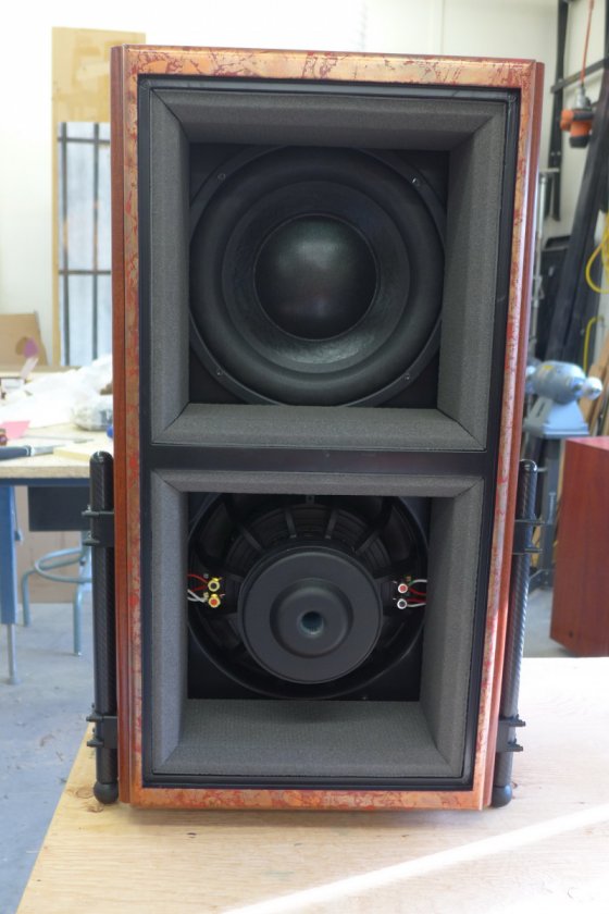

« Reply #6 on: 24 Mar 2022, 06:56 pm »
Mitering the corners  and then bevel cutting the front/rear  face of the no-rez helps the appearence tremendouisly.
You  mentioned  making  grills, did the  grill frames we sent  not  survive  ?
Also, feel free to post  some  pics  in ouir sub thread when  yoiu're all done :)

Re: Subs with half the no-rez
« Reply #9 on: 25 Mar 2022, 05:44 pm »
Hey Noah
Glad to hear  they made it,  was worried you were having to re-make  them.
Our  sub flat pack thread is  here:
https://www.audiocircle.com/index.php?topic=139480.0
And here's a pic of what  I was   speaking of for the no-rez with mitered corners/beveled front / rear  edges
And here's similar on my Super 7's
You  can make the   face bevel cuts  at   whatever  angle  you like,  I've done  some  at  45's,  some  at    60 just  for  a slightly different look
If you  cut  all the  no-rez sheets into 12.875" x  24"  with a  45 at  each  end,  you  can then   cut your  strips   from thaose and add the  beveled   faces
jay

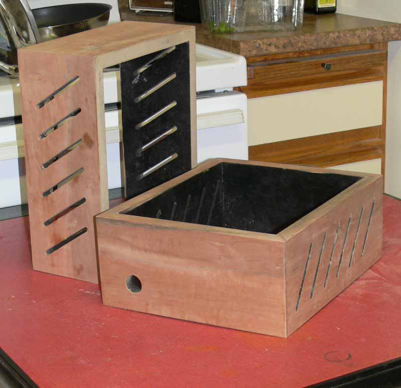

« Reply #10 on: 25 Mar 2022, 07:44 pm »
Here's another look at miters and bevels. Like you, Noah, the visual aspect was what moved me this direction. Functionally no difference.
Easiest way I've found to do this is band saw. I go into some more detail here, about halfway down the page.
https://www.audiocircle.com/index.php?topic=139529.200
