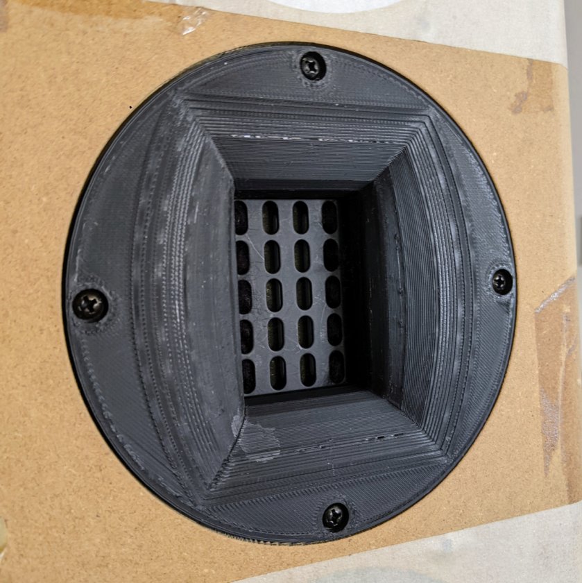

We used to offer exactly what you're talking about. The old N3S model used a BG Neo3 PDRW with a deep back cup along with a pair of M130 woofers (not sure about an X variant)
Danny and I worked on designing a custom waveguide for the GR Neo3 last month which will work well with a back-cup and we've got a design we're really happy with. So we're excited to get the samples back and possibly reviving the old N-series that will sit between the X and NX kits in terms of performance.
Here's one of the final prototypes:
We sent the samples of the waveguides off too the manufacturer a couple weeks ago. :thumb:
We currently expect the GR Neo 3s back in stock by early April.
The waveguides and deep cups may take a little longer however.
Good news is that the cabinet plans won't need to change from their original designs.

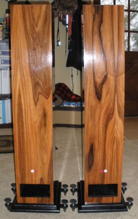

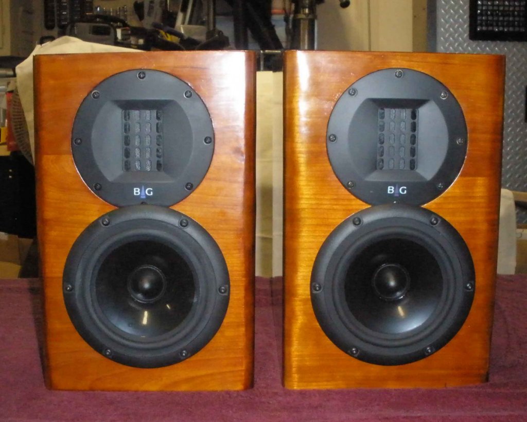

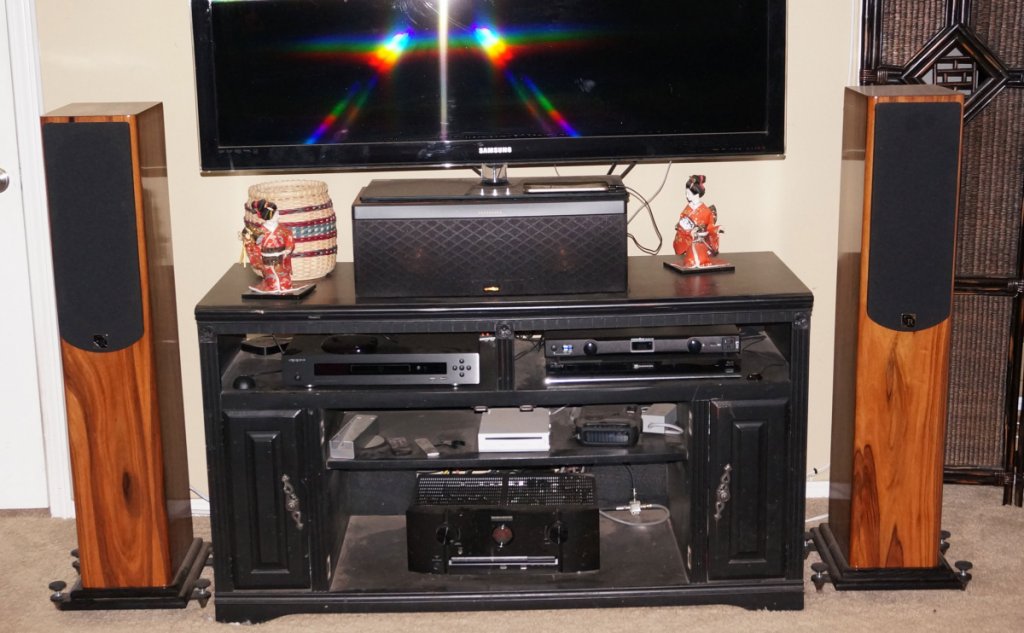

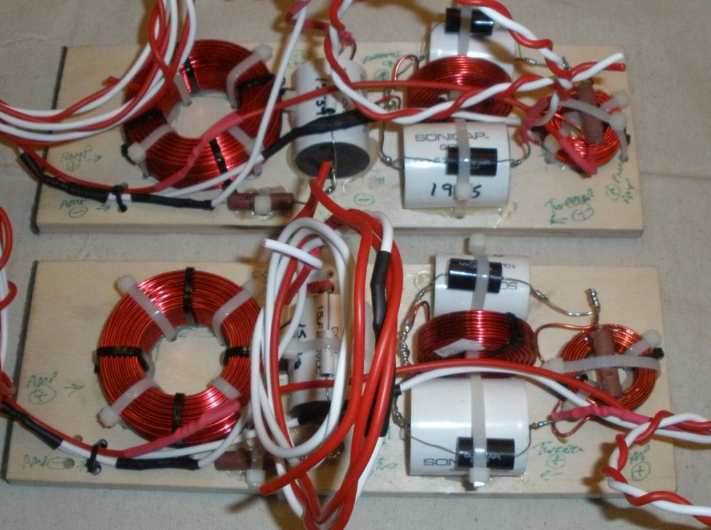

The N-Series speakers are fantastic, especially with an upgraded crossover. I have both the N1X monitors in my wife's personal system and the N3 towers in the living room system. The N3 towers differ frox the X-MTM Encore both in the drivers used and in cabinet design. The X-MTM Encores have a ported cabinet while the N3 is a transmission line design. Sometimes you'll see folks refer to it as the N3TL for this reason.
I built both the N1X and N3 about 9 years ago and the N3 is still my favorite box speaker.
N1X
N3
I'm happy to see the N-Series coming back  :thumb: Kudos for not giving up on it

Fascinated by your description of the N3 towers. From what I understand, transmission line design while difficult to pull off can be the best of both worlds for bass as far as speed and extension. Did you design that cabinet? How deep do they go in room? Makes me wonder if it would be possible to do a transmission line design in something like the N3S design Hobbs mentioned, or is that just crazy talk?
mlundy57
  • Posts: 3643
Re: Tweeter for m130 based mtm
« Reply #8 on: 13 Mar 2022, 02:58 am »
Mike, those are truly beautiful! I am a fan of your work. Love the finish on those xls encores on Ron's channel and the NX Otica monitors you did.
Danny designed the cabinets. I just built them to his plans. The N3 is designed to be -3dB at 40Hz. In my living room they go down to 28Hz. However, that extra extension can sound a little bloated down that low so I cross them to a sealed servo sub at 40Hz. This makes them great for both music and movies which is how that system is used. For most music the sub isn't necessary with the N3.
The N3 is an N3S with the addition of the transmission line. You can't fit a transmission line inside the N3S cabinet. The N3 doesn't take up any more floor space, nor is it any taller,  than an N3S on a stand.

Very cool!  I'm especially interested if it has the 1.5" recess to put the tweeter in phase.  It makes such a huge difference with that tweeter.  It's such a difficult tweeter to get right, but it sounds so good!
Currently, the plan is for a roughly 3/4 inch waveguide. Thats the deepest we can use without needing a bigger waveguide and mounting hole. But we may explore a larger 1.5" version that fits into a waveguide more similar to the NX kits.
That said, the measurements were really good. It'll be interesting to see how it perfoms vs the original BG models.
I'm very interested after working with the waveguide that N. Tracy designed for me.  These tweeters are so sensitive to how they are mounted.  We ended with a 1.5" deep waveguide, which really makes the phase clean.  However, even a 3/4" set back is going to be great.  I look forward to what you guys come up with.
