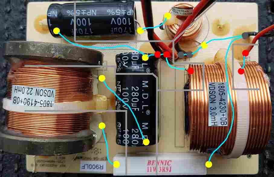

Ofcourse I couldn’t resist opening my KEF R700 loudspeakers to learn it has indeed some “cheesy” parts, like the way he likes to put it. For this reason I would like to ask your help.

Is it reasonable to upgrade this crossover?
I know it’s easier for you if I have a schematic, but these are glued in and when I remove them I can’t go back. So I’ll add some pictures and a schematic from the larger version (R900), whoes schematic is very very similar, only some values differ.
The only difference between the R900 and the R700 are the bass drivers (8 inch instead of 6,5)
I will also include some pictures of the binding posts, which will look horrible to you.
My question is: Is an upgrade within reasonable limits worth my while?
Which improvements have the best price/result?
If I upgrade them, what’s the best way to fix the boards back, without damaging my speaker?

There are opportunities to improve the parts quality to increase resolution.
Certainly the electrolytic caps and cement resistors can be upgraded to modern film capacitors and non-inductive wirewound resistors without any drawbacks other than it won't be the original KEF voicing anymore. The Bennic film caps could be improved but modern bennic films aren't as terrible as some other low cost film caps, and I don't know how good the older bennics were. So the improvement there may be be less, but you can probably hear an improvement with modern films, especially if you're willing to spend some money. But while you're in there fiddling with the electrolytics and resistors might as well do all the film caps if you're going for max resolution. I like Jantzen red caps for sound and value but there are many good caps available now at all price points.
The air core coils are probably adequate just as they are. The magnetic core coil on the woofer is a large 22uF, so that will need to remain magnetic core, and the one you have looks fine.
Keep the old parts so you can revert back if it doesn't sound as good with modern parts as you hoped. :D Good luck!

At the very least you could try replacing the cap and resistor in series with the tweeter.  You may be able to get matched Sonicaps from Danny or another brand I like is Clarity Cap CMR series.
The caps in series with the midrange are an interesting choice in values.  One is 1/10 the size of the other which makes me wonder if it’s a bypass.  It might be better to parallel same value caps to reach 75uf and then add a 0.1 bypass.  Here I would suggest Clarity CSA caps as they’re a little cheaper than the CMR but have the same character in the midrange.  The difference is the CSA are not as good in the treble which makes them better suited for mids.
Yet another option is to send one to Danny to see if it needs any optimization.

I have the R700 and love them.  I also listen to a lot of classical but unlike you, I get a clean string tone.  The issue of slightly metallic sounding vocals happens on a few tracks, you don't have a silk dome to mask that, I attribute that to the recording quality.  I do have the  4db 125hz dip in my room but that's about it.  In room response is great otherwise.
I really doubt messing with this crossover will improve the things you mentioned.  The smaller R500 were tested by soundstage network and the THD was impressive.   Really great for massed strings.
Look at room acoustics and placement before these mods imo.

Regarding modifying your (very tasty) KEF R700 loudspeakers I will vote on the yes go for it especially given you report to be “a young audiophile who works professionally in the electronics/hifi-world for about 5 years now.” In my experience in technology in general and HiFi specifically nothing teaches us faster or expands our knowledge better than going hands on.
Starting with the areas that will yield best improvements per Euro if I had R700s I would go at them in this order:
  • Replace all electrolytic caps in crossover with audio quality plastic film. If HiFi specific caps are out of the budget look into Wima MKP range these are available in larger (for plastic film types) values 10-47 uF and of course paralleling will add up the values needed to match the electrolytic being exorcised. If budget does not allow replacing large value electrolytic immediately at least parallel them with 0.1 uF polypropylene film caps
  • Use Danny R’s magnet trick to identify ferrous parts in the signal path (#1 suspect binding post nuts and washers) and replace with non-ferrous (likely brass) substitutes. This can vary from getting brass nuts and washers all the way up to audio grade connectors like WBTs.
  • Add damping to the cabinet walls. Not acoustic stuffing, mechanical damping that is adhered to the MDF walls of the box. If importing NoRez from GR is too expensive look into the Bitumen panels from jantzen-audio.com. To work the damping pads must be adhered to the box inner walls.
  • Replace existing plastic film caps and power resistors with better audio grade components. About time to look at the internal wire and get rid of any that uses PVC.
  • Final least cost effective change is replace inductors with identical L values in heaver gauge wire or foil conductors.
