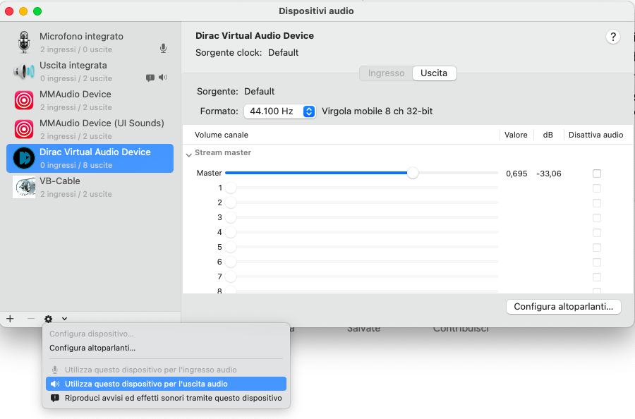

I've bought a used NuPrime uDSD, and would like to connect it to my Linux desktop.  However, the device are not being picked up, I actually have the same issue on a Macbook Pro 13" (Mid 2012, running Catalina).
did you try to go to " go " > utilities > audio midi configuration > left column there is a list of devices....you should find them udsd nuprime > you have to activate it as audio output, to activate it first click on it when it turns blue go down, there is a wheel, open the drop-down window on the right and click on "use this device as audio output"
Have you already done this procedure?
