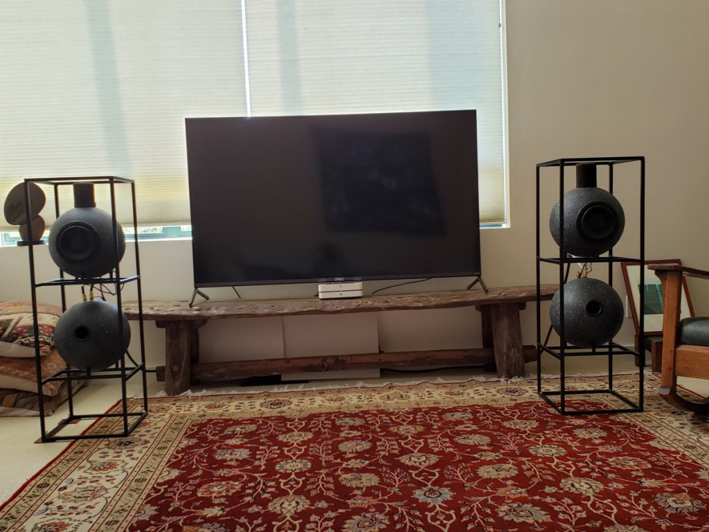

Martin09
  • Posts: 7
Re: Bluesound Node 2 No Longer drives pre-amp
« Reply #19 on: 4 Mar 2022, 10:25 pm »
The new Powernode has replaced my Adcom 500 series amp and pre amp. Too many factors involved for a fair comparison since my new room environment is near optimal, I haven't had the old gear set up for 6 months, and it has been years/decades since the Anthony Gallo Nucleus Reference II speakers (always satisfying) had enough space to perform their best. Also, that gear likely always underperformed as paired with the Gallos.  All that said, I'm blown away by what I have now. Don't mistake this for a review :?, but the bass smacks and the snares sizzle in ways I've only heard recently in audio showrooms. The Ref II require very little power, and the Powernode is more than adequate on that score. No doubt there's opportunity for an upgrade. There always is. Thanks AudioCircle for all the helpful input.
